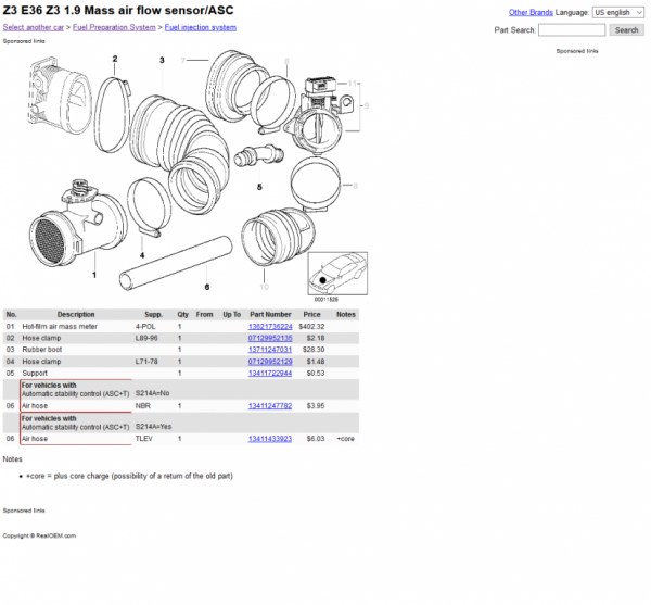

Splits or holes in the rubber hoses will cause idle issues and mess up fuel trims as the car tries to compensate for the unmetered air entering as it thinks its running lean hence the smell of fuel. These engines require a good sealed intake and vaccum system to run correctly. https://www.realoem.com/bmw/enUS/showparts?id=CH71-EUR-06-1996-Z3-BMW-Z3_19&diagId=13_0418 for the parts you will require. If you go to the home page enter last 6 letters and digits of your Vin number to access the listing of parts for your particular car. I always use Sopers BMW at Lincoln for parts they accept Zroadster forum and will give you a discount and post items to you, they are very good to deal with.

Thanks for that fellas, but it doesnt show the smaller pipe coming off the intake pipe.
Thats the one on mine thats split
