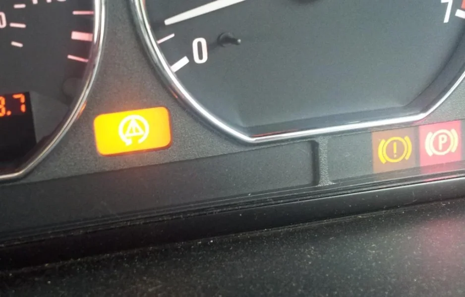

Just started having these two (yellow) lights both staying on for one journey, but then both going out on the next.
Any help much appreciated. Many thanks indeed. Tony.
