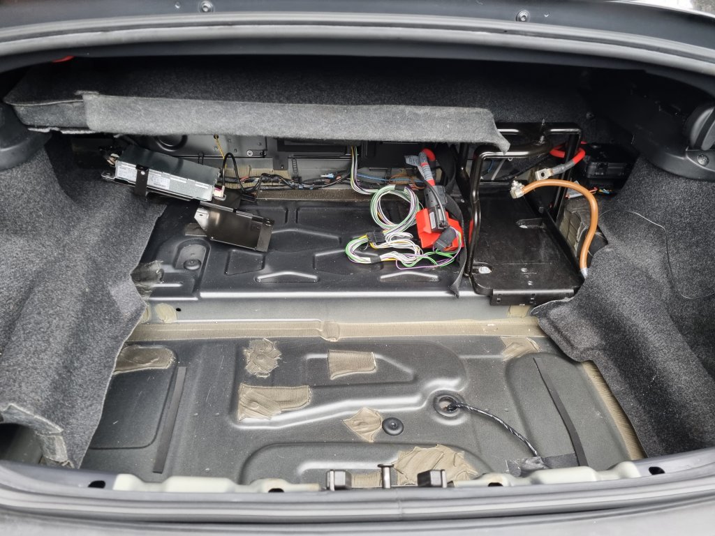

I managed to resolve the issue - sorry I should have updated this post but I think instead I included it on my progress thread for the car.
Anyway the issue was the wrong Bluetooth Passkey had been written in the manual - only confirmed once I had strippsd the boot lining to get to the Bluetooth module :bashhead:
