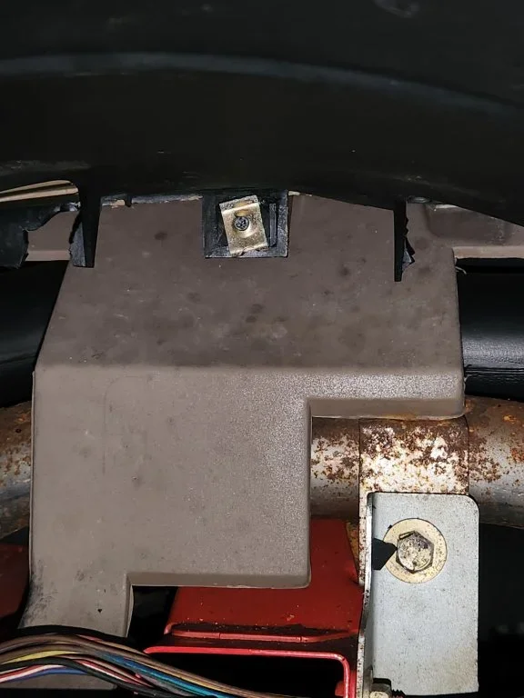

I hope someone can give me an idea here. I had to remove my instrument cluster and because of a combo of the car plastics being cheap and 9 hundred million years old the binacle broke off. At the back is a plastic bracket held on by a Philips head screw. Of course the screw head is on the wrong side and I can't get to it. (See pic) what you see in the picture is the ass end of the screw deliberately taunting me.
As I'm sure you all know the space is tight so it's impossible to get even the smallest of screw drivers back there.
Does anyone have a suggestion as to how I can remove this screw without further screwing (pun intended) up the bracket.
The gold clip in the picture is the "nut" being used by the screw you are asking about.
If you can grab the edges that surround the screw and bend them you will in effect remove the nut and the screw should fall out.
They look like this;
Called "spire nut" or "speed nut".
I took your suggestion but unfortunately the plastic bracket broke. So I'll have to figure somewhere way to secure the Binacle.
