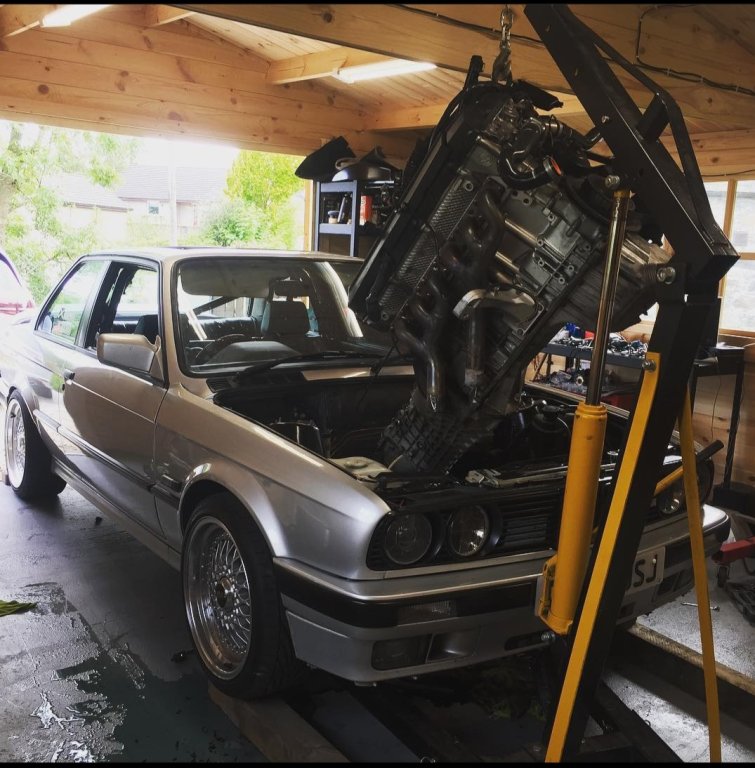

Its pretty quick to drop them out the bottom if you have a 2 post ramp. I've removed a few that way and it gets the job done.
The z3 will be a luxury being able to remove the front. Making hoist Work much easier. My experience with m5# engines and a hoists is you're best to do it with the gear box attached as lining things up after can be a struggle.
When I took the m52 out the e30 for the s50. Tight but she goes.
