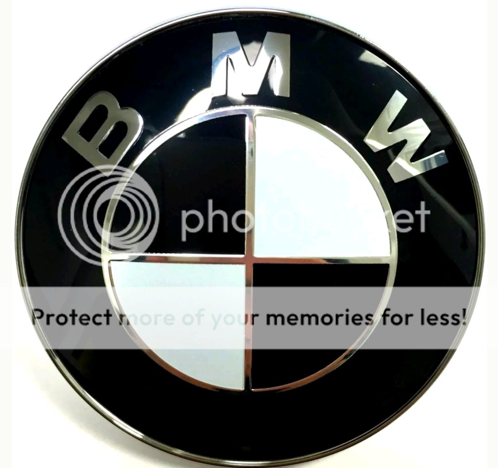

I am thinking about changing the bmw badges on Gloria to black and white ones, not the carbon fibre look just plain black and white like the one below. I think bmw used to sell these at one point but there seems to be some non oem on ebay..
Can anyone recommend any of the seller's / products?

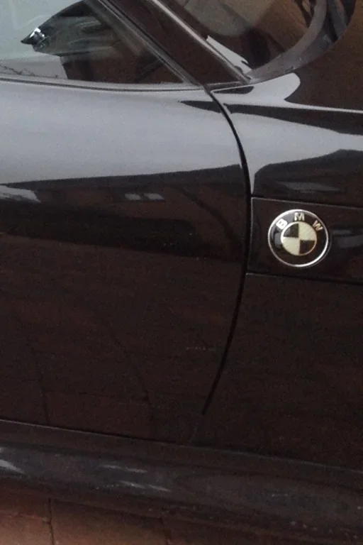

Also, can anyone tell me how to change the badges on the bonnet side gills.. l seem to remember reading somewhere that they are in fact stickers?
billz
Dec 4, 2011
Langley Mill
The side Gill badges if i remember are push on. I know when i went to the carbon badges i had to make the holes a little bigger to fit the after market ones

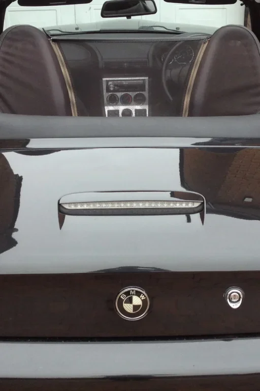

I done all mine and used this seller for my carbon ones (will prob do black too) but remember to specify you need 2 x 82mm badges for bonnet and boot (z3 specific)
http://www.ebay.co.uk/itm/282060935498?_trksid=p2057872.m2749.l2649&ssPageName=STRK:MEBIDX:IT
For the side grills you need 78mm and they are like rocking horse sh***. They are stuck on and have 2 locating dowels (like the front and back) so just use some heat and a plastic trim removal tool. Speaking to @Low Rider last night and they appear to be sold out. Worth contacting him to see if he can produce anymore. (i have no affiliation with any of these companies)
http://www.ebay.co.uk/itm/322167085486?_trksid=p2057872.m2749.l2649&ssPageName=STRK:MEBIDX:IT
You may also need to buy the small rubber grommets if the ones on the car are perished, they come in packs of 2 and are only a few quid. If you have any trouble locating them let me know as i may have some spare.
http://www.ebay.co.uk/itm/BMW-BONNE...622442?hash=item27dc4aed2a:g:hbYAAOxyVaBStJMc
P.s will look much better...do it!

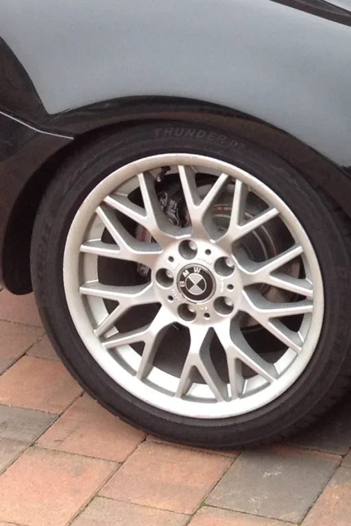

I have change my wheel inserts to black and white........looks much better with black wheels
