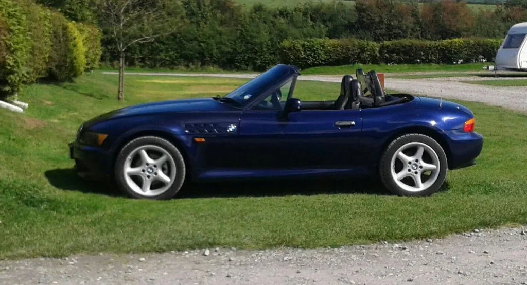

Not sure if you'll remember me (some South Wales guys will) but I had a silver early Z3 last year and since have had 2 x Z4s and a few non BMWs too. I always had an E46 330 in the background which has been replaced after 8 years ownership with an E93.... but I had a spare evening online yesterday and turned up a cheap Z3 over the bridge and thought it would be rude not to have a look at it!! And I bought it! Really wasn't looking for another car but a cheap/good Z is a good thing!
It's a 1998 16V manual car with some nice options - working electric roof, black leather heated seats, aircon, factory hoops, speaker between rear seats, 17 inch staggered style 18s, full service history and on 113k miles with long MOT and recent oil service. It's got a couple of things which need sorting like a hunting idle and a clicking noise from the front NS brake calliper (has stupid clip on calliper covers that I think is the culprit, which will be gone shortly). It's got silly stickers all over it (which will be removed) and i got money off so the guy could keep his luggage rack as I don't like them.
I'll be heading over the bridge soon so @colb can cast his beady eye on it but it didn't miss a beat on the 50 mile thrash back from the valleys. Pictures below, if anyone knows the car then please chip in. Oh and I bought the car off a guy called Crook, and it has no V5 - I'll wait til the police turn up! Haha!!

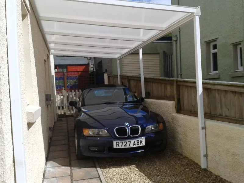

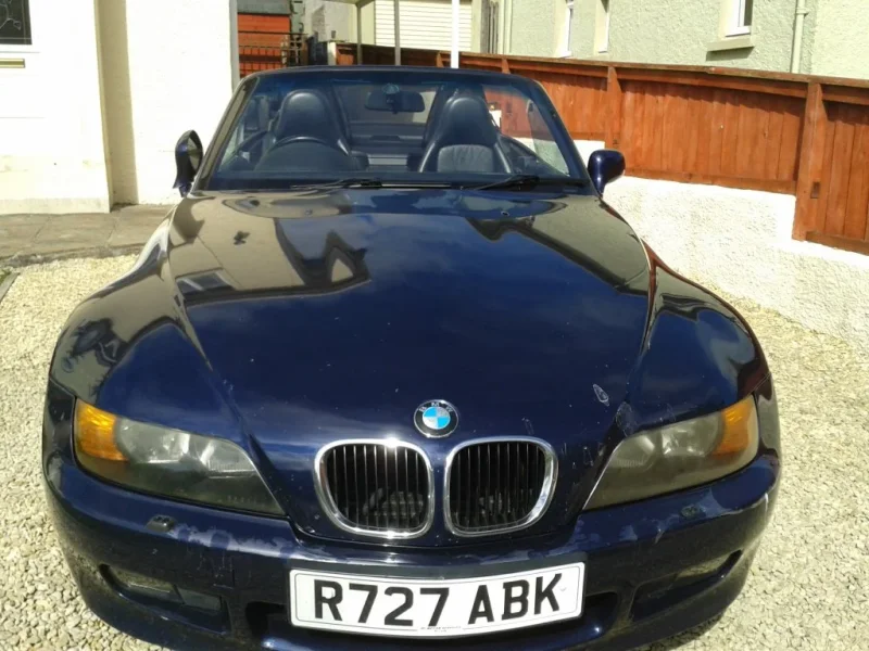

I recognise that car , bought it from BMW in Plymouth about 6/7 years ago , it had been in a garage for about 12 months before they got it , nice little car always went well , it did need some bodywork on the bonnet as started to suffer with the top coat peeling , I bought a 2.8 so sold it to a guy who did cars up in his spare time and he gave it a respray , I think he sold it to someone in Cardiff area and I think they could be responsible for the bling , when I sold it it had the original radio fitted and the only thing that didn't seem to work was the headlight washers , I'm sure you will enjoy as she's a great car to drive and so economical it's unreal , enjoy

I had a clicking noise on my 2.8 when braking coming from front offside wheel turned out to be the clip that holds the brake pad in the caliper had come loose from back of pad changed pads all good , couple photos when I owned the car
