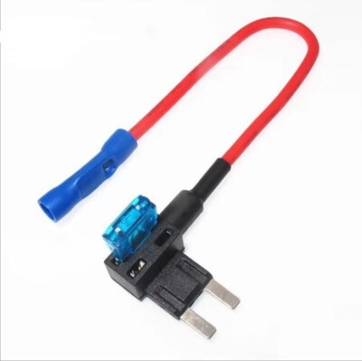

So, looking into my fuse box for a safe place to run a fuse tap, I am finding fuse #6 to be a live 20amp fuse for “heated rear window and rear window blower”... I have a 1998 2.8 with a soft top, pretty sure there’s no heated window or blower. Why would this be a live fuse, and would this be a good place to tap into to run small aux lights? The light harness has a built in 20amp fuse...
Sep 23, 2012
222
Stafford
2.2 & 3.0 Sport
@Mint and @gookah have done this they may offer advice
I cheated, I took a meter to the electrical sorting out box by the master cylinder (RHD). I picked up an ignition fed live from there.
