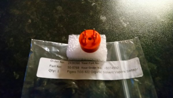

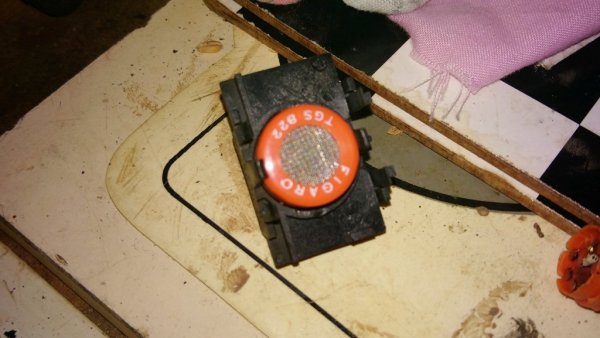

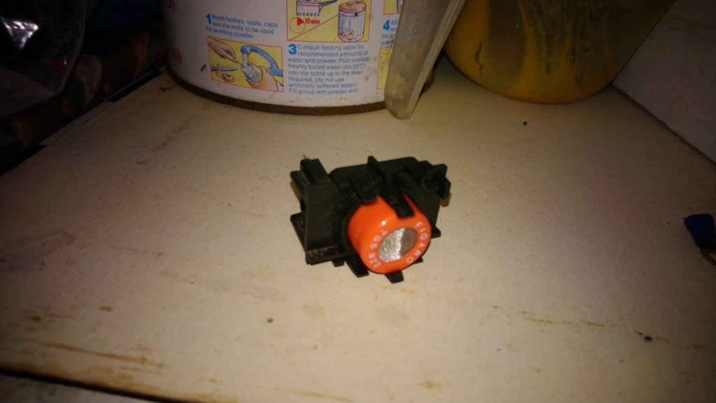

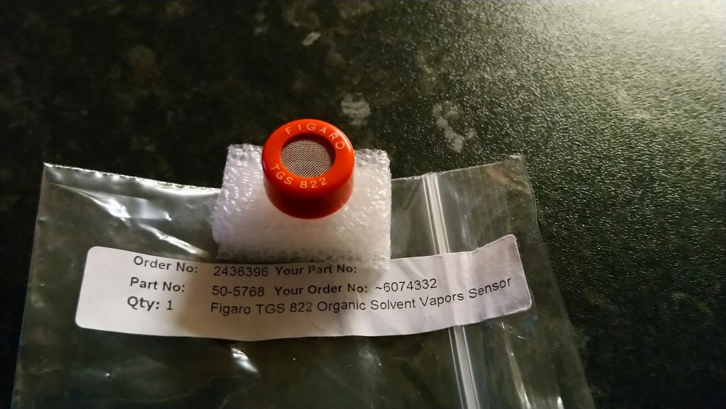

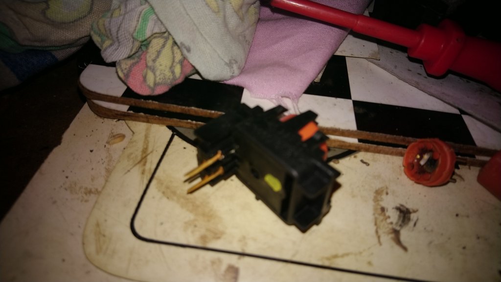

Fitted the new Figaro sensor into the plastic sensor housing today.
The internals are held in by four plastic spring clips which when lifted clear of their stops allows the internal bit that houses the sensor and the connection pins to be slid out of the housing. Once out the sensor needs pulling out of its pin sockets, its held in by two plastic spring clips that can be flipped back with a flat blade screwdriver whilst using another screwdriver to lift the red senso up to clear the tabs, don't pull on the red housing with pliers, the red cap will pop off leaving the working bit still inside gripped by the pins. Carefully lever the sensor upwards working around it so it lifts up and out. Take note of the orintation so you put the new one in the same way.
The pins are a very tight fit and hold on, they are not soldered in there so quite some force has to be applied to get them lifting out.
Poped the new sensor in making sure the six pins went into its socket the same as the old one, firm pressure downwards pused it back in till the two securing clips snapped back to hold it in. Popped the unit back into the housing and replaced the small foam filter material when doing so. Refitted to the car and will check if the error code returns next time I scan the car with BMW Scanner 1.4.
The new sensor cost me £17 with postage, BMW wanted £70 for a replacement!!
The Figaro sensors are used in smoke detectors and industrial applications.
