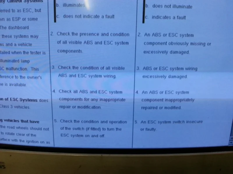

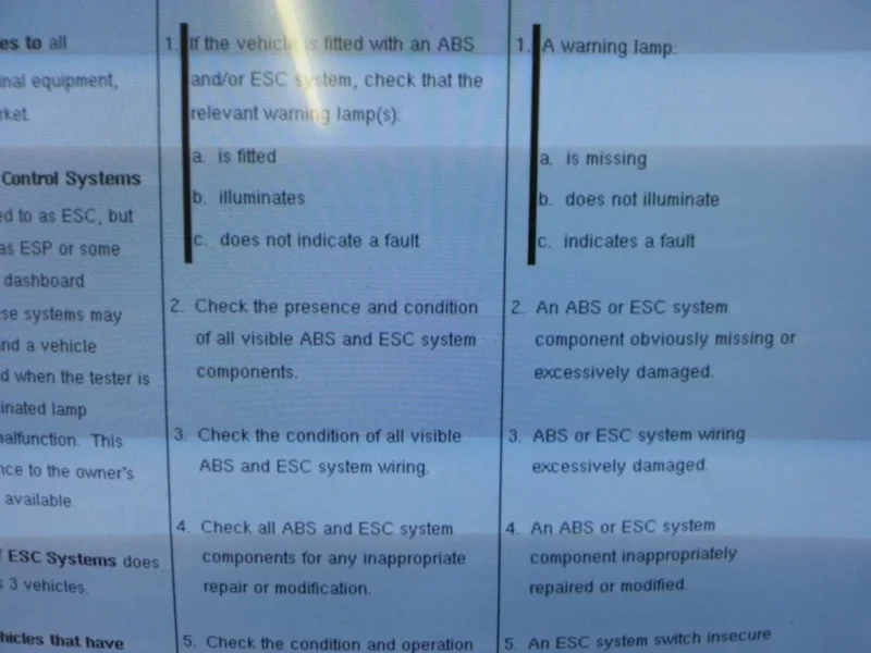

changed rear shocks and springs all went well but when i got into the car the asc light would not go out, nothing was disconnected, cleaned the sensor but still the same, it failed its mot on a broken spring now i guess it would fail for the asc light on, have ordered a new sensor working on the idea all was well before i started the work so may be a wire as got pulled ?
