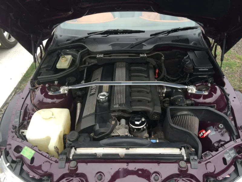

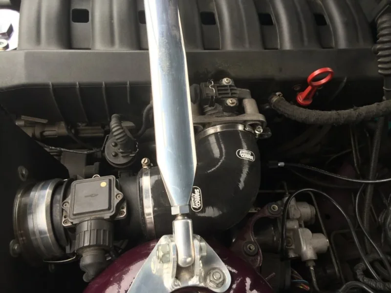

    In preparation for installing RaceLogic Traction Control on my 1998 M52B28 fitted with ASC (not DSC), I have removed the whole ASC butterfly valve assembly & fitted a smooth intake boot for better airflow and of coarse the 'ASC' light is on as expected.
    My understanding is the the ASC operates by cutting the air take & apply the brakes.
    My objective is for the ASC to do absolutely nothing & I have already achieved the first part of that by removing the valve assembly so it no longer effects the air intake. This is clear. No problem.
