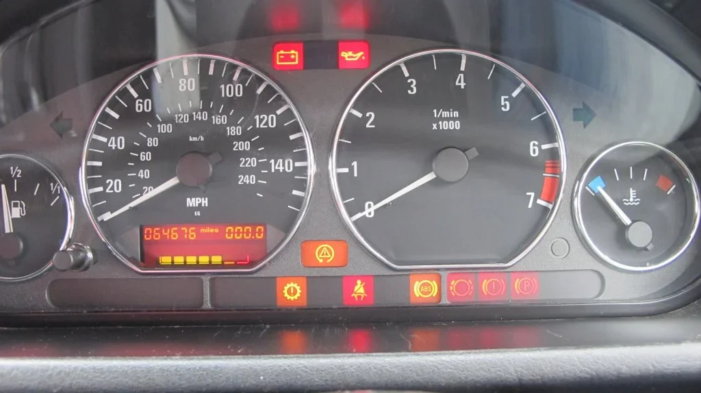

..... I have pressed the button which I assume should light up green but it dose not........
The button does not light up - the indication is in the centre of the instrument cluster - does that light up on start-up checks?

On mine if i press the asc button it lights up the symbol on the dash. It means it is turned off. When on the dash light illuminates only when it is active. Normally when accelerating on a poor surface

Press the button and its turned off and the dash light will be permanently illuminated, if it activates during driving when a loss of traction or stability is sensed it will work automatically and the dash light will flash during operation.
