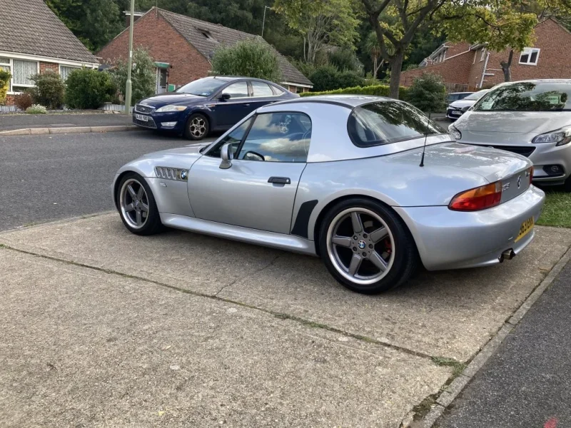

I took the hardtop and fitting kit off my red car and put it on my silver car. The perfect fit on red was a terrible fit on silver! I had to adjust the rear fittings on the near side to lift the roof about 5mm so it didn’t touch the bodywork, and the bracket on the header rail also needed moving do the screw lined up.
it’s definitely warmer and quieter withthe roof fitted

Make sure you have the mounting brackets if buying a roof, and I don’t connect the heated rear window so that’s not a major issue.

Yes, I have around6mm clearance now. You can do it by sight. My roof was touching the body on one side so it was obvious what needed moving. It’s about even all round now and fits a treat
