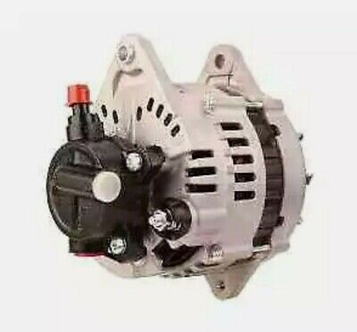

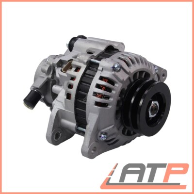

Not sure if it would be an option but you may look at an alternator from a diesel. Since a diesel doesn't provide a vacuum source some have a small vacuum pump on the back of the alternator just for the power brakes.

I am pretty sure my old Ford Ranger had one on the back of the alternator. Did a quick google and Discovery's came up with one on the front.

Thanks, I do like that solution, I didn't know they existed. If my pump doesn't work then this will be plan B.

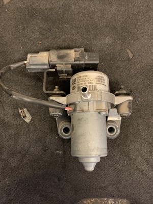

I had one of these alternators on a Bedford Midi diesel i had for what i can remember they had to have an oil feed and drain as well and were prone to filling the alternator with oil , just talking to friend of mine he has had a similar problem with his kit car and said use one from a BMW i3 cheap enough on Ebay and just need a electric supply

So the Corsa pump on the back of the alternator needs an oil supply? That's going to be a problem. Does anyone know of an alternator with a vacuum pump attached that doesn't need an oil supply?
The great thing about the alternator driven pump is that it isn't e;ectric.

Looks like the Corsa alternator with vacuum pup is going to be my best bet.
It looks as if the vacuum pump on the back has 3 connections, one for vacuum take of and 2 for oil flow and return, please correct me if I'm wrong.
The oil flow and return, I don't have any take off points that I can use, I presume that the oil is for lubrication and not for cooling. Do you think I could get away with a loop of rubber pipe filled with oil to provide the lubrication?

I currently have an electric vacuum pump from an Audi fitted, it is very noisy, louder than the engine at tickover and it runs very hot so I was hoping the pump on the alternator would be quieter and more trouble free.

From what i can remember the bedford midi the oil lubricated and cooled the vacuum pump if they got to hot (which they did frequently ) they used to fill the alternator full of oil
