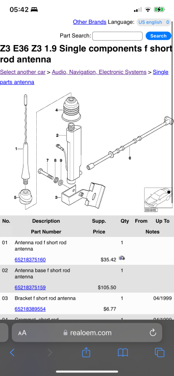

PhilH67
Aug 2, 2021
59
Derbyshire
2.2
Is it this part you need?
