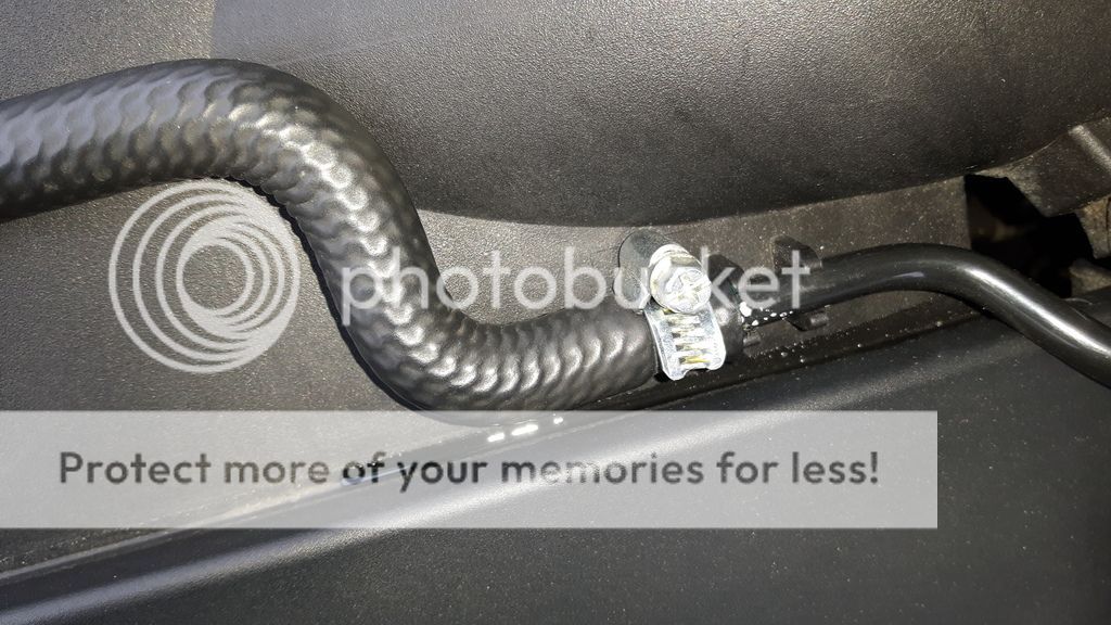

@Alan W - Hi Alan - I had exactly the same problem as you but mine was a big patch of oil on the garage floor and when I started the engine the power steering pump squealed which did give me a bit of a clue. I had to remove the under engine cover first but once that was off the problem was easy to see. The crimped connector that has already been mentioned had failed so I replaced it with a jubilee clip, filled up with fluid and it's been OK ever since. I did give everything a good wipe down while I was under there and gave the pipework a coat of Hammerite - to show there was no ill feeling (no photos of this though). Here are some photos I took when I repaired mine. Hope they help you...

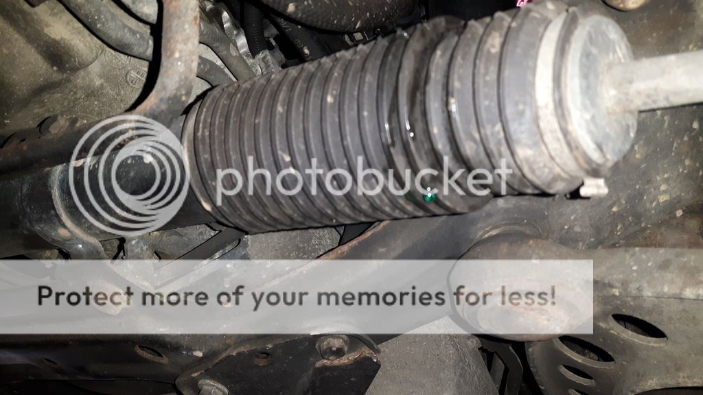

Poked my head under front of car this morning and without my glasses l could make out a damp patch and drip forming on the o/s steering rack gaiter..
Jacked it up and crawled under and with glasses on l could see that fluid was blue meaning anti-freeze...
A quick exploration and l found that this joint was leaking.. its a return pipe from radiator to header tank and it runs across the top of the air box.. l had replaced the original factory clips with jubilee ones and had been cautious when tightening as the thin pipe is plastic.. clearly too cautious so a gentle extra half turn was applied and fingers crossed we will be fine..
