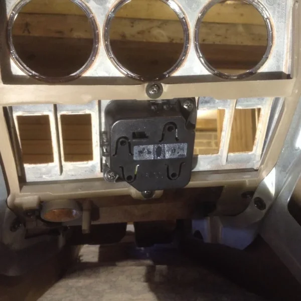

I can advise you that the centre console will have to be removed to get the clock out as it is fixed in with 2x screws.
As promised photo of how the clock is fixed. I do not think you would be able to remove it with the console in situ.
It is held in by two screws.

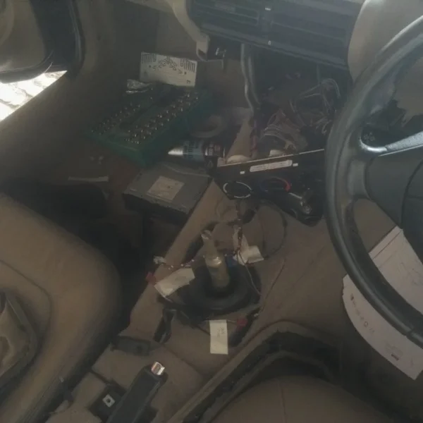

It is possible - just - to do it with the centre console in place as I had to remove / replace my OBC that fits in place of the clock using the same two screws. Being right handed I:
a) removed the screws from the console side trim on the drivers side (your passenger side) - the trim is quite flexible and can be bent back.
b) pushed out the two switches/blanks (one each side of the clock).
c) with a helper sitting in the passenger seat holding trim back removed the electrical connection and then the two screws.
d) when refitting I taped a piece of ribbon across the back of the OBC (/ clock) with each end of the ribbon passing through the openings one to each side.
e) position the clock, helper in the passenger seat pulls on the ends of the ribbon to keep the clock in place, fix screw to end of the srewdriver ( I used masking tape) and fit.
Note: I ended kneeling outside the car with a cushion on the cill to make life a bit more comfortable.

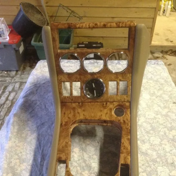

Pictures Here
