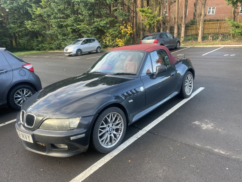

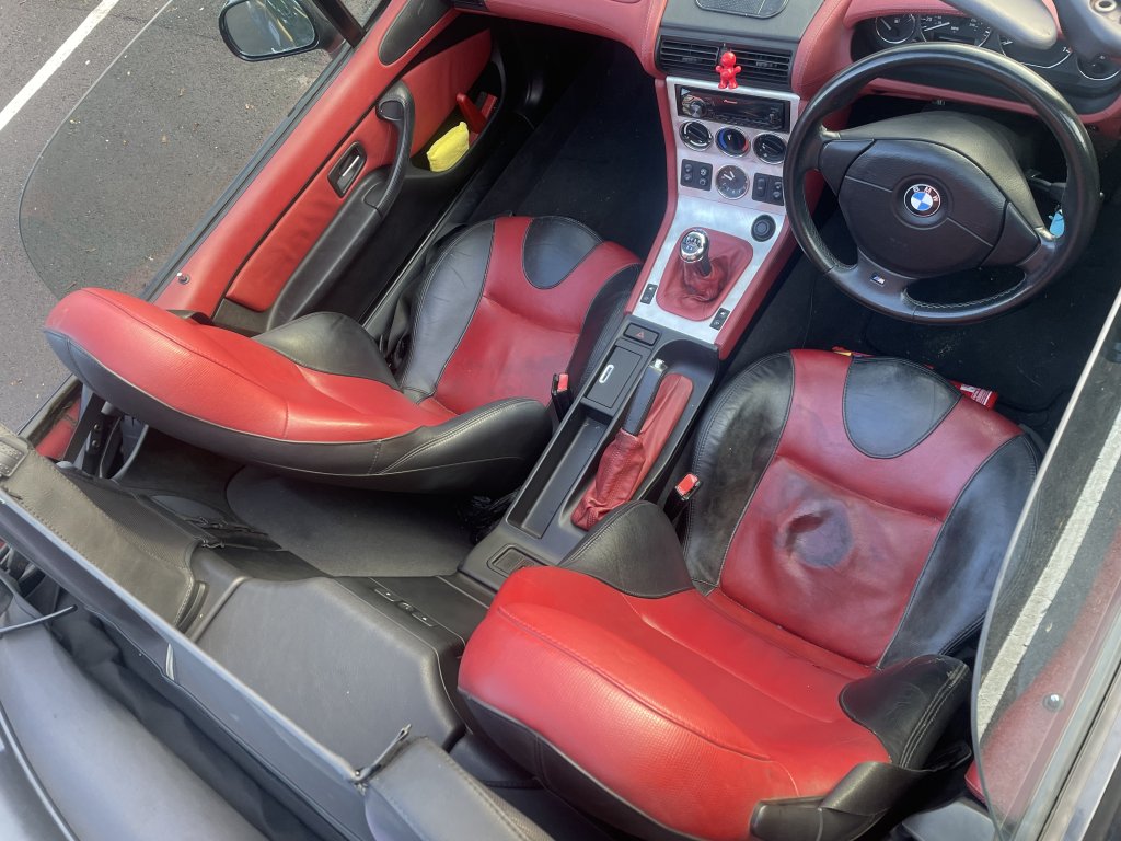

Some pictures of the interior possibly, with the roof down would help someone make a decision on rescuing it. Nearer 24 than 21? Mileage is irrelevant really.
Just stretched picture out. My bad. Shame you're not closer.

I've got her back from my local BMW specialist and snapped a load of photos this morning. This shows how she looks after an autumnal round trip to west Cornwall (and not a half mile trip to the car wash!). Plenty more photos available for those of you so inclined. She has a toolkit, warning triangle and after-market Pioneer radio with USB port, although the speakers are awful.
As I'm all for transparency, some pertinent points, some of which are probably 'to be expected':
  • There's obviously lichen on the roof.
  • Occasional water ingress, in heavy rain, via the driver's side window seal. I read that 'Gummi-pflege' is the one for this.
  • Stain on the driver's seat which pre-dates my custodianship. Probably a former owner letting too much rain in.
  • Minor oil leak from what I think is the rocker cover.
  • Slight rattles from the transmission on occasion, when accelerating/changing gear from a standing start.
  • Rear window plastic has seen better days. Glare on motorways at night can be a bit irritating.
  • BMW badges are 'tired', to say the least 😂.
I've DMed those of you who've got in touch, so thanks very much there. More generally I welcome observations/feedback/etc from all following this thread.
