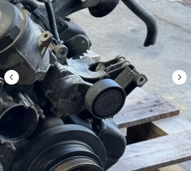

does this look correct for my car, 1998 2.8 m52 R26MDE
This is what you are looking for.
No wonder that belt is noisy looking at the state of it. If you remove the top part of the fan cowling you will be able to get a much better picture.
I changed mine in March 2023 at one of @t-tony 's Shed Days. Cost about £65 iirc and we fitted it in under an hour. Hardest part was removing the viscous fan [left hand thread] and cowling. It was the spring type not the hydraulic type. Mines a 2.2 M54 but gives you an idea.
