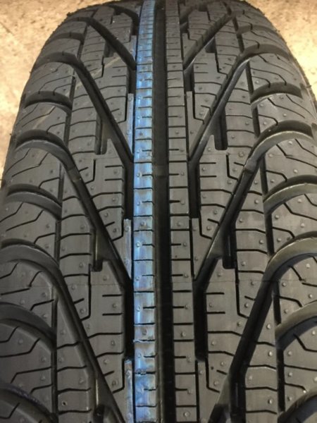

If you're keeping the 16's, I can recommend these, I run the clio daily 130 miles a day up down from Perth/Glasgow on them every winter
Kingpin Weatherspeed retread, ran my wife's 1 series on them for years, her current car would have been on them too but they don't come in 17". The snow tyres I ended up with are quieter but not as grippy. Terrifying levels of grip. 50mph on 4" of snow, piece of p***.
