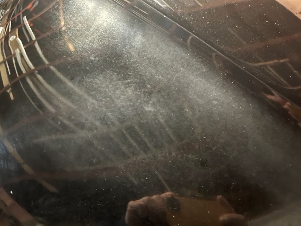

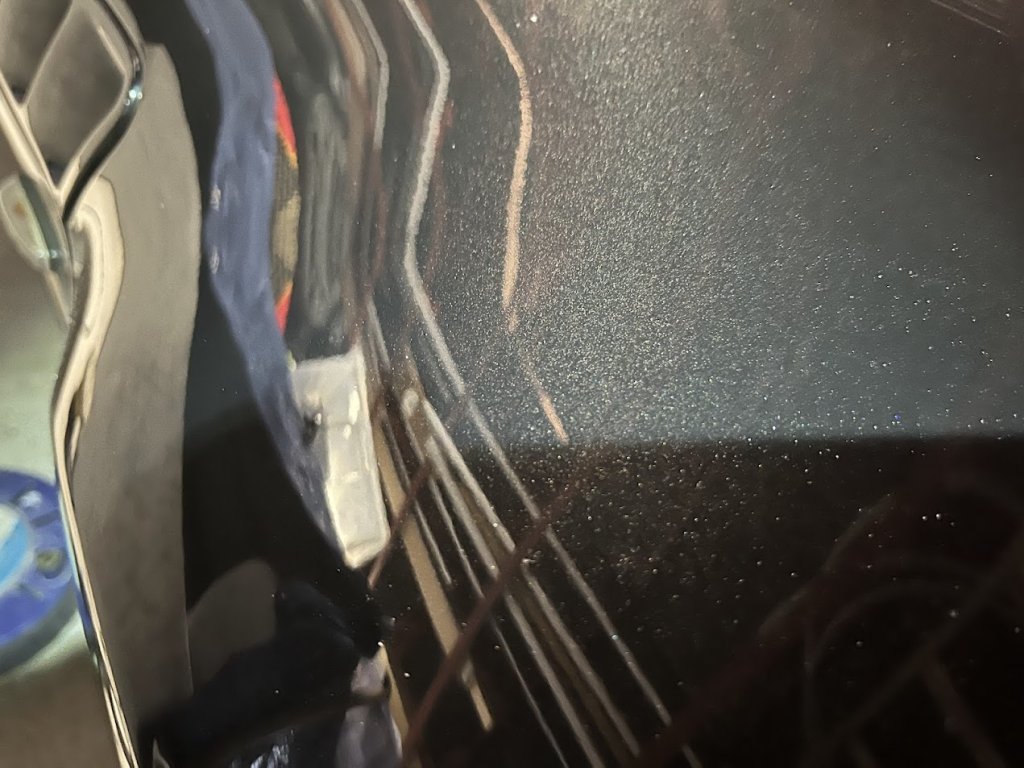

I spent a good few hours taking advantage of the fantastic weather we had this weekend and treated the car to a full machine polish and wax, to my surprise, most of the heavy oxidation was lifted, a few before and after shots;
Heavy Oxidation on the bonnet;

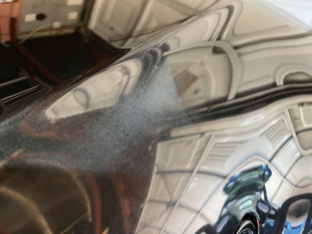

After a quick test patch with a cutting pad & Menzerna cut force pro;
50/50;

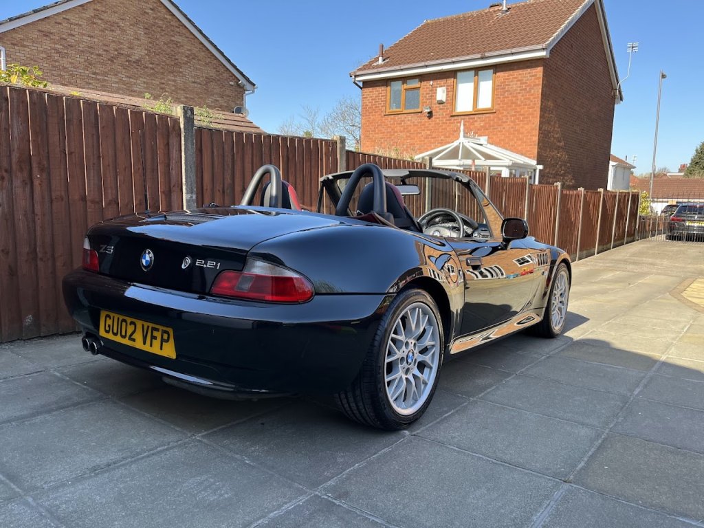

Final result, I wet-sanded and polished the headlights also;

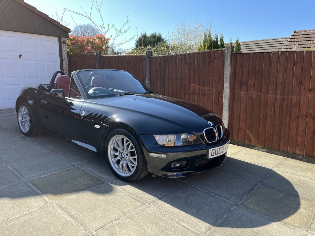

I tried on a set of Style 66 I had laying around from one of my old e39's - I love the rear fit, however the fronts are a tad too wide.
Will be on the lookout for a different set of wheels over the next few months, quite fancy a set of wheels with a nice dish.

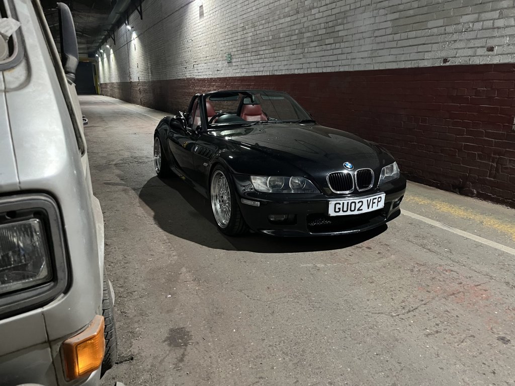

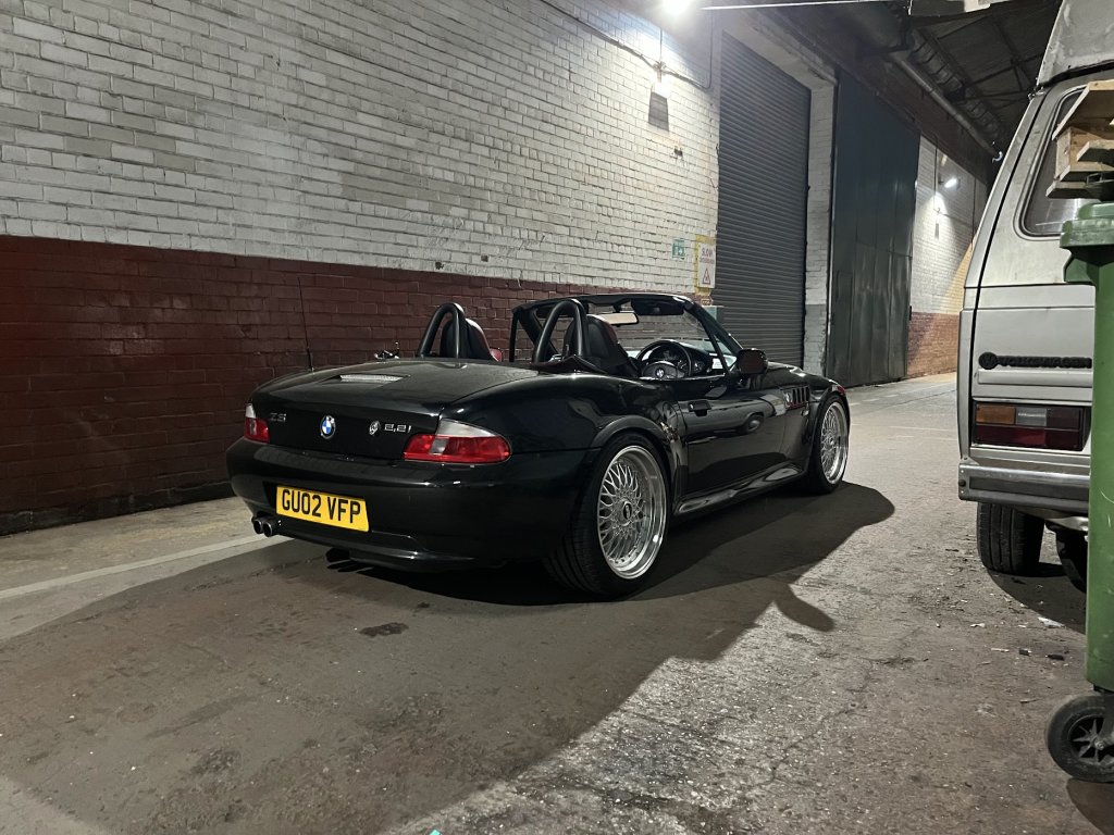

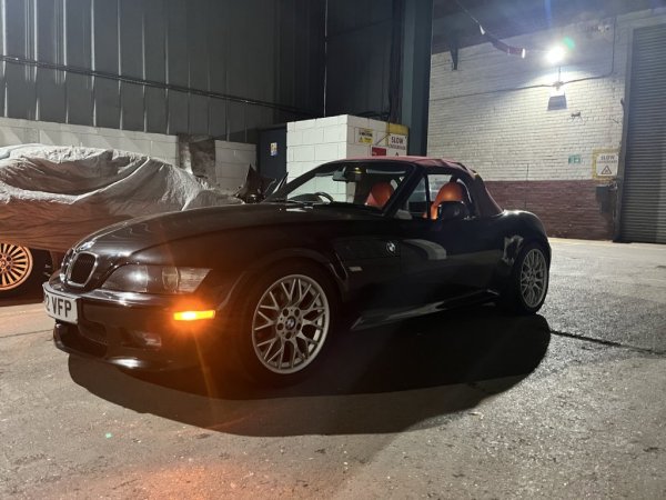

Friday night after work saw the installation of a set of MTS coilovers, along with a set of rear upper and lower braces and some wheel spacers.
My word, what a difference its made - its completely changed the characteristics of the car.
The original suspension from 2002 and 155k miles was certainly due replacement.
The ride is much more firm, which is exactly what I was after, the car feels more focused.
The car will only be used occasionally, the budget didnt quite allow for all singing all dancing coilovers, at the same time I didnt want to go for cheap and nasty ones (been there, done that), these seem a good middle of the road option, only height adjustable, the springs are also supplied by Eibach.
Its sparked another level of excitement to be fair, I enjoyed driving the thing already, this seems to be quickly becoming my favorite "fun" car.

2.2i is a good choice and this one looks to have a nice spec as well. A ‘sport’ front what I can see. Looks lovely after its polish.
The E39 wheels are perfect on the rear but the fronts will be 15mm too much poke from the arch. For the fronts, 8 inch width with Et35 offset is the outer limits for flush arch fitment. I run 17x8.5 et41 on front (rear z3 wheels) which is same equivalent poke. Any more is going to need skinny tyres, shims or camber plates.
Having the trailing arms and subframe bushes done is a massive plus. It’s quite an involved job to replace.
