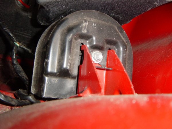

The photos below show key type and siren for the `98 version - I think yours may be next generation but principle is similar. Black plastic cap is removed to insert key and turn siren off.

There are a couple of different alarm systems used as standard in the Z3's over the production runs. It depends on year and in which part of the world you are. Maybe you could update your profile with your location and the model of Z3 you have?
In general, there is a key switch on the siren. Have a look to see if you have such as switch, then search the stuff that came with the car. Do you have a key? They are rather hard to find a replacement for if you do not have one.

Hi,
I have now had a chance to look under the bonnet but 2 things become very clear - I do not have a siren like in the above picture. I also do not have a key like in the picture above - I have 3 keys - 2 working remotes and one key without the remote device attached. My keys look also different they have 3 buttons and a small red light. I button for lock, 1 for unlock and 1 for turning on the inside light. The 3rd key is a key for the doors and ignition only.
So what does a 2nd generation siren look like ? and how is it disabled - with another key seems unlikely I cannot see on any piece of "black box" any place for the use of a key.

Photo now available
I have taken the siren out and examined inside the "black box" siren to see some rechargeable Varta batteries which I suspect are the issue as the car had been sorned for quite some time.
Does anybody have any experience on changing the sirens for a replacement one - is it the same for other BMW cars e.g. 3 series?
As always, any help would be much appreciated
Kind Regards
Brian

Sorry - no experience to help you Brian, but out of interest is there a BMW part no. on it or a brand name if it's an aftermarket.

There is a part number on the rearside in yellow ink - but sadly some it is worn off (as indicated by ?), however the numbers read as follows:
12V GB ?52? AIO3 ??
BMW 8 383 ?54 12 ??

Time you explored www.RealOEM.com.
Here is a starter for 10, well it's item 6 actually. https://www.realoem.com/bmw/enUS/showparts?id=CM12-EUR-09-1999-Z3-BMW-Z3_19&diagId=65_1011
Click on the part number to see what other cars used this siren. Do you know anyone parting out a Z8? But there are others in the list.
To use RealOEM. go to the homepage above, enter the last 7 digits of your VIN into the search tool and with a few easy clicks, you can search for part for your car. It pays to bookmark the page just after entering your VIN when the car breakdown is shown. That way the page is easy to find for the next parts search.
