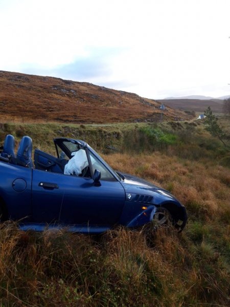

2 days ago i bought what i thought it would be a good doonor car which is same as mine same year same 2,0 engine topaz blue with blue interior,
Mainly i wanted it for hood which looks like new and seats are imaculate,, also doors are in good nick and mirros base are imaculate,,
I bought it from a guy that took it to nc500 and went off road, so both airbags deployed
Windscreen cracked, wishbone bended and front bumper is broken,, but after driving it 200 milles to my home i thought to my self what if i try and save it,, engine was serviced just before he left to do nc 500 and it had new throtle cable and it wasnt reported to insurance company, i bought it wery next day,, engine on this doonor car sounds so nice and it actualy runs better then mine,,

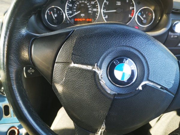

Basicaly i was wondering if i should try and save it so my main question is regarding airbags are they as simple as just replacing them and plug them in, there is no lights on dash and car drives nice except it pulls to right becouse of lower controll arm,, if anybody knows more about airbags i would love some advice,,, thx in advance

The air bag in the steering wheel is just plug in so will be easy to replace. I would think that the passenger air bag is the same although I haven't had any experience of this. One of the forum breakers will be able to answer your question, @Synclare @mrscalex @spurs fan in a coupe

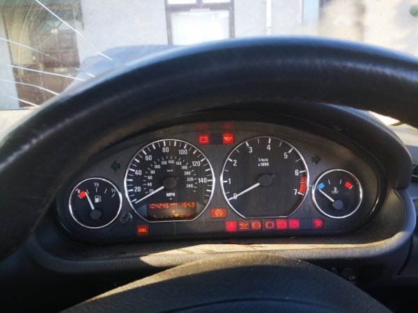

Airbags should just plug in but I am not sure why you don't have a light. I would expect the system would have a light and needs to be reset after everything is replaced. If so its easy to do but makes me concerned someone has disconnected something else.
The system must have been in working order or the airbags would not have deployed? Perhaps the fact they have both deployed is the reason there are no "lights" on?

The airbag light should be on and codes should be thrown. I can’t think of any legitimate reason they wouldn’t be present. You will find one or more sensors that will need replacing as they are one time once the detection is made. That alone should be throwing an error. Never mind the resistance being detected from an open circuit on the airbags.
It’s technically possible to code the airbags out but I’m not sure that would have happened. Or maybe dash/dash lights are broken/removed.
I suggest you get a code reader on to get the real picture.
Airbags are a simple enough swap. I have various but I wouldn’t want to post just in case they go off.
Will be interesting to find out what codes are stored when it comes to resetting the system.

If it stays on (may come on and go out - can't remember) then that is the error light. It seems to be staying on?
Anyway. You will 100% have errors stored. And modules that need to be replaced.
The main crash detection module (under the console by the gear lever on facelift cars at least) will have self-destructed. As will 1 or more of the sensors under the carpet. I forget what sensors are on which versions of Z3. And which self-destruct after a crash. But I'm talking about lateral acceleration sensors and Yaw sensors. You may also find the battery blow-off detonator has been launched - that also will give the airbag error.
To be honest you have quite a lot of work there. Including have the crash detection module coded to the car.

Am I missing something? the airbag light is the one on the bottom right that is lit.
