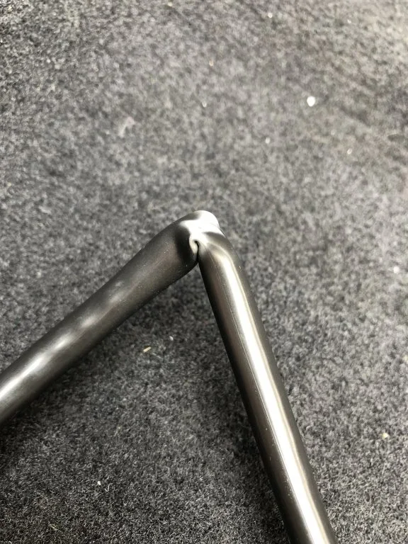

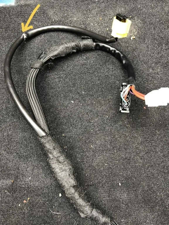

Steve61
Nov 24, 2020
59
Reading, Berkshire, UK
Z3 2.0
Like many Z3 owners, I had that pesky airbag light come on, but thanks to the numerous threads on this forum, it was an easy fix.
Brought the B800 off eBay, but got that vague code 02 “warn lamp” and resetting wouldn’t clear the code. So out came the driver’s seat and I could easily see where the cable was getting snagged from seat adjustments. Thankfully wires not cut right through, cleaned up connectors and ensured pushed fully home. Cables now tied back out of harms way and code reset and cleared. You can see from picture where cable was getting caught up and presumably pulling the connector out.
Okay, not the most advanced job, but very satisfying for a novice. Will probably check under the passenger seat to avoid any future problems.
