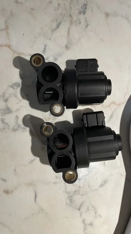

Well, actually I have two.
but they are the after market ones so they will not help you.

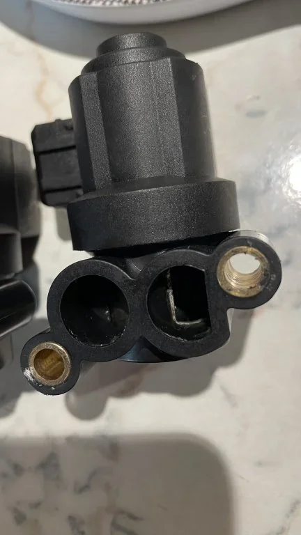

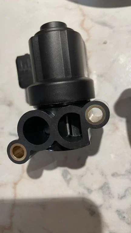

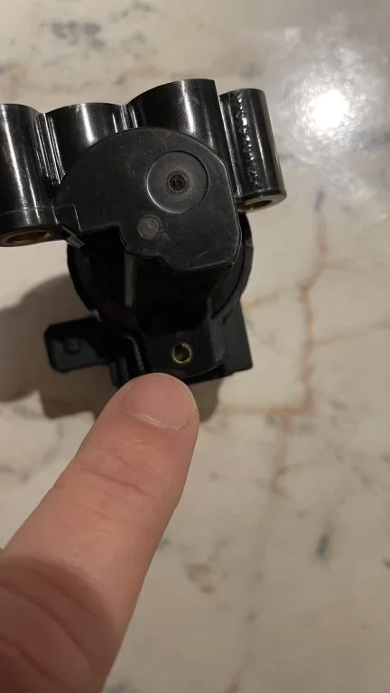

check the photos below, the gap I am talking about is normal at the first one and totally off at the next one.

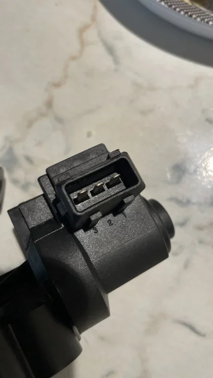

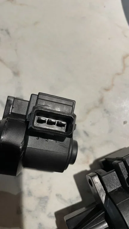

please also be carefull when ordering because some have four inserts and others have three (and they do not plug to later models).
i had to grind the one with the three in order to fit in a desperate attempt to save money.
it did not work.

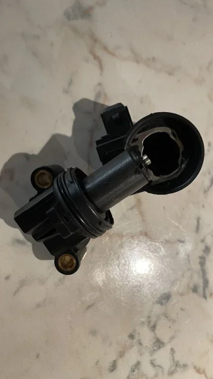

and do not I REPEAT DO NOT try to pry it open to clean it watching youtube videos BEFORE removing the safety pin. (The one I have my finger on) You will destroy it. The idiot who uploaded the "repair" video is a total jerk and reaponsible for all the broken valves they blame him for. And as you see, there is nothing to repair in there.
(Last photo).
