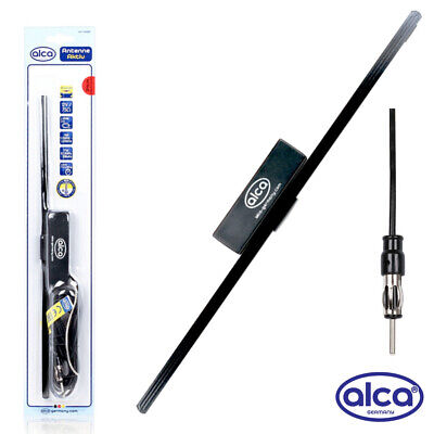

When I had a similar problem in the past, with another car that I owned at the time, I went for this option and blocked up the grommitt hole with a rubber plug.
Here is a link to an ebay advert :-

Hi Mike
Thanks for the link. Certainly not expensive
So I have two cables to hide ?
Not too sure how I do that on a soft top. I'll have to have a look at the possibilities
