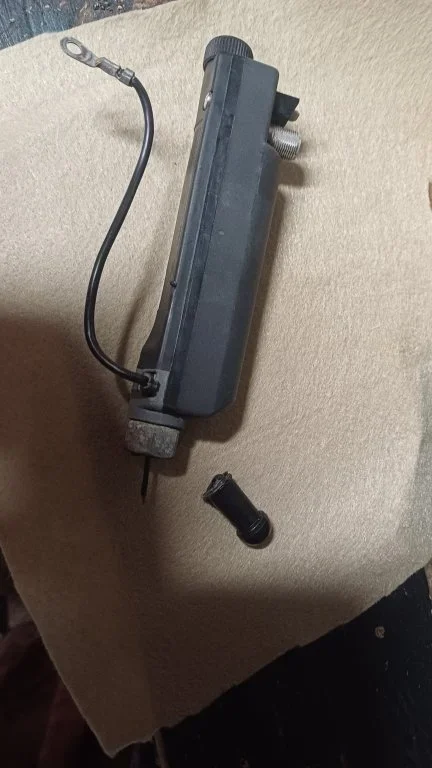

had a few mins to look this morning, and it would appear, that the actual antenna box in the boot is broken, so not taken it apart as of yet, too cold and already fed up with the weather hampering everything i need to do, so im now on the hunt for the part... great.

Yup it's broken and there's no way to even get the broken part out and replace with another . What a crap 💩 design this is.
Iv glued it and used some silicone stuff in the vein hope .

There is a tiny braided wire that runs up through your broken part that breaks when the plastic end breaks, I did manage to repair mine then glue the plastic part back on using epoxy glue but it didn't last had to find a good replacement in the end. The wire on the base of the unit is a power feed to the built in amplifier, be careful you don't short it out on the body when removing/replacing the unit.
