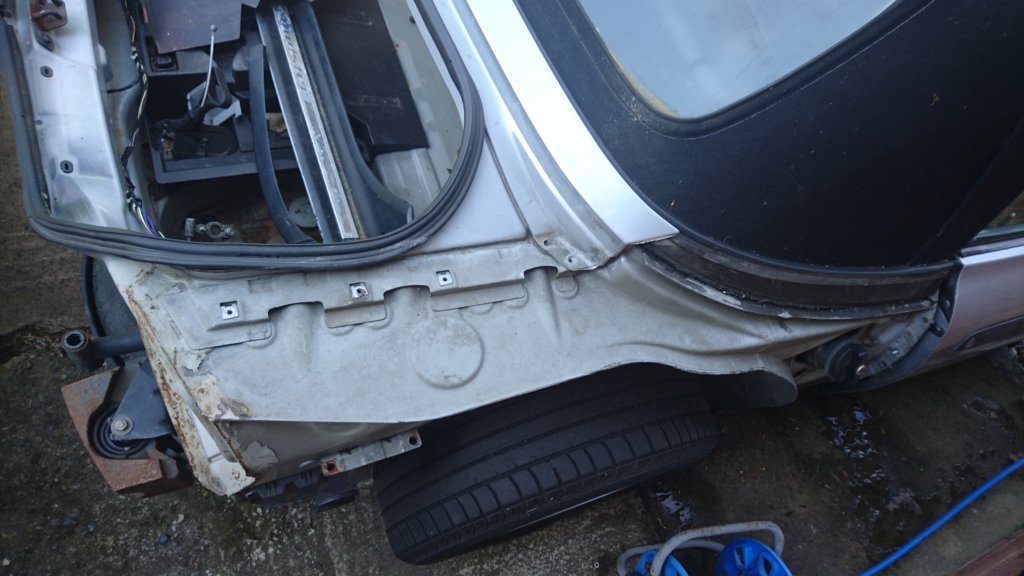

I took the off-side cover sill off my Z3 yesterday as it was getting a bit crunchy, as part of this I completely removed the inner rear wheel arch cover and saw this :-
A big bit of rusty steel fell out too.
Here's a couple more of the inside :-
The outside isn't looking great either :-
So my first question is about the horizontal bit thats missing - is that a seperate panel or part of the rear wing? The picture on the database (http://bmwfans.info/parts-catalog/Z...n2001/browse/bodywork/outer_panels/#8413374_5) isn't very helpful
Is this worth repairing or should I look at getting a replacement panel? If I go the replacement route I'll need to get it sprayed so its probably worth doing both sides and possibly replacing the sill covers too.

Yes mate,the rear wing has a little shelf where your photo shows the rust patch

Hello, if Andy can't sort your needs I have an offside wing from a 2001 car, finished in black though. As Andy says that missing plate that fell off yours ties the wing to the inner body. I'm in Leicestershire too. Can paint it if you wish but to be correctly done it needs 'flicking' into the door panel to avoid any disparity in shade. Not good spraying to a shut line as most do.

It's a not an uncommon place to go. My project Titan Silver 2.2 went in the same place. It's definitely scrap. Get secondhand - there are plenty of Titan Silver parts out there so hopefully you won't even need it resprayed.
Only a couple of hours work to swap it.

I've got a couple of wings and sills from someone on ebay, correct paint code and a lot less rusty.
I waxoyled and stone chipped them yesterday so its rear wing off day today and hopefully back toegether again in time for MOT next week.
