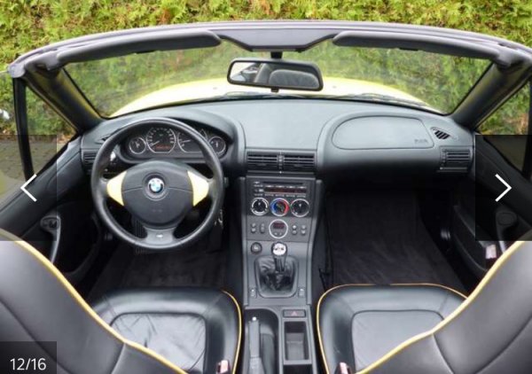

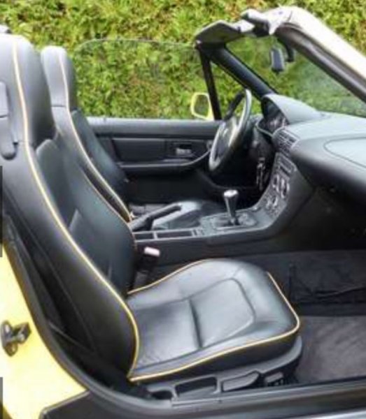

Also what is this weird interior/steering wheel which has the seats of the Individual Dakar but the console is not the right one, nor are the side panels which should be yellow as well, I think, and also I never saw that kind of steering wheel? Is it original or an aftermarket addition? The seats seem right.

Hi Luca, if you can get the last seven digits of the VIN and put them in here it will give you the spec of the car as it left the factory. The steering wheel in the picture is an m sport wheel, an optional extra from factory.

The M sport wheel is the same as my Dakar individual ( bar the yellow bits which someone has done aftermarket) the full black walk nappa seats with the lemon piping are also same as mine .
But like said above with the last 7 of the vin number you can check the cars factory spec should show those seats etc on there if fitted from new .

Stevo, which aftermarket yellow bits are you referring to? In my pics?
Ok, so I think I am gonna target the yellow 1999 2.8 in the pic above.
Because the car is far away from me, before I schedule an appointment I need to make sure that it is worth the trip so I will request the vendor for some additional pics:
- service record (partial done at BMW)
- front seat and steering wheel
- engine?
- what else?
- is it possible to verify the trunk floor condition from a picture?

just the yellow bits on the steering wheel should be black somewhere along the line they have been re coloured looks fine with the yellow bits in my opinion.
Also if it is a proper Individual model ( which appears to be by the seats )
On the inner wing it will have a plate on both sides one is the vin plate as fitted to all z3 but on the opposite side you should have an Individual model one similar to this one on mine

Thanks Stephen got the pics from seller today, the individual tag is there!!
