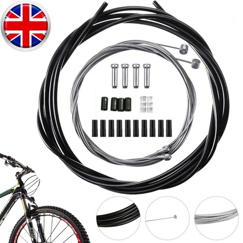

Strange that Autodoc search didn't come up with the product using the part number search. Might be worth taking it to a motorcycle cable supplier who can make up a replacement using your old one as a pattern.
Could also try a repair kit for the inner like this.
Cable outers also on ebay, comes with ferrules to make your required length https://www.ebay.co.uk/itm/265705397812?hash=item3ddd469e34:g:uugAAOxyIj5SBVim&amdata=enc:AQAIAAAA4HtpuNUguQ4E4RTJEMoT9Pk5FGCXIeQSoy4kOJQSnWbLoM5MPFDCVYtXXBLjQ3sKFRcgLFZljLDcN7PQRFJaaXVuaUuolW8Imx3zZxCH1hb5KsZeIOXjDkfpy7Kb+FCU79nVvNK2meLsESUvljmJ8jsVkIhmrGQJ6sPcr5MHt5nzAfzh+JiO0e5qBtqJFA6YSHC7wwI5mkKwUyZFIbIfP5ptMRcvGqdwVmb2rI9zBv09bDMGvwmgRfbg1rabJOgAU8MdrBQPdP/BKia8d6rlaN7IfKFjH3oIRnO6N928lVXT|tkp:Bk9SR-Cvnr2jYw
Set also available here
