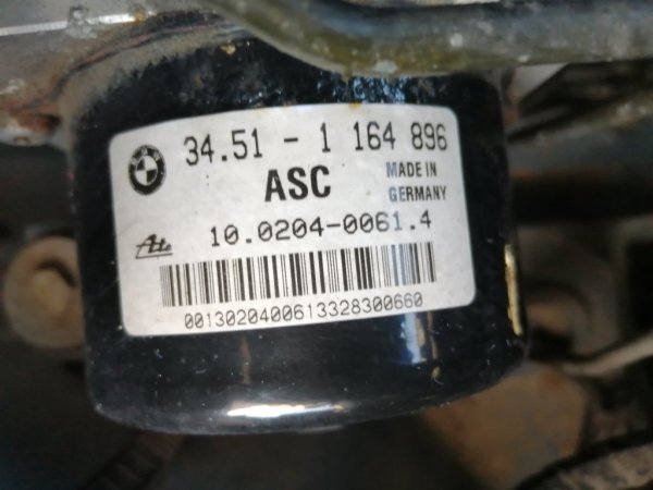

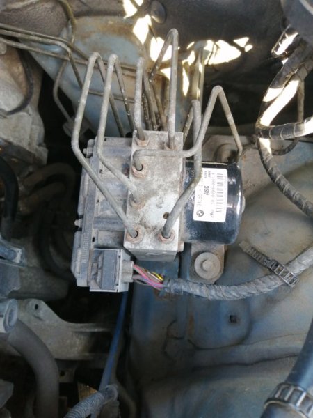

Thanks, Ianmc and Stevo7682, for your responses. I have attached photos of what I am looking for. My ABS light on the dashboard has come on as well as another light which has no initials but has an exclamation mark inside a triangle inside a round arrow. I have no idea what that means.

So the picture above of the full pump wilth all the pipes coming out.
This is 2 pieces
You have the hydro unit ( the alloy block with the pipes and pump motor ( second picture) attached
And the abs pump control unit ( the black plastic bit with the wiring going in).
So if the fault codes show up the pump as the problem its very rare that the Hydro unit is the problem it will be the control unit.
Now you can separate the control unit from the Hydro unit without affecting the hydraulic side of the brakes
All you the is the black bit on top of multiplug pry gently up this will release the multiplug at the 4 corners of the control unit you will see 4 small inverted torque bits undo them then you can gently wiggle the control off of the Hydro unit ( it will have a part number on it to match for direct replacement)

Firstly now get another control unit.
My 1.9 is covered up just now my 2.8 tu pre face-lift has the later abs pump ( same style as yours) .
Unfortunately the 2.8 engine bay is a bit tight compared to the 1.9 so this is was kinda the best picture i could get of my module as you can see part number on front of it so you can match it.
On left side of pic top and bottom you can see 2 of the 4 mounting screws like i said you can take it off without affecting the hydraulic side of the brakes.
Stephen
