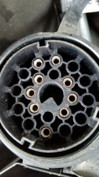

@Cheddars
Your car is pre facelift like mine is. The facelift diagnostic port may be different to the pre facelift as I believe the C110 works fine on facelift Zeds.
If your diagnostic port is like mine above, with the same pins, you can only access the ABS module through ADS programme on an old laptop connecting through a RS232 port. BM Cables diagnostic kit will work but only via a proper RS232 port.
I went through this rigmarole last year with my car.

I have been using the one under the bonnet, can't seem to locate the one under dashboard. It looks exactly like the one pictured above - the pins are in the same location.
Dumb question - does the engine need to be on or just ignition?
Cheers guys, it's greatly appreciated.
Just ignition on mate.
