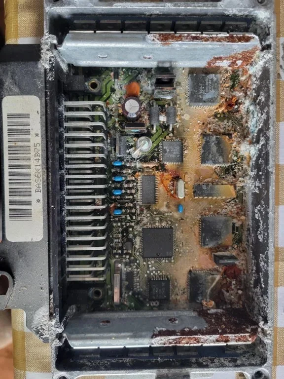

The ABS/ASC light have been on since I got the car. Because of the water damage, some of the module needed replacement. The ABS controller was severely corroded. I've installed a replacement and was able to turn off the warning lights, but after a test drive they came back on. A new scan indicates, among other things, that the "gearbox type wrongly coded." Also indicates that the ASC microprocessor is malfunctioning.
