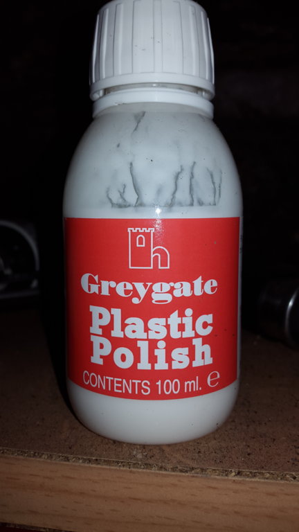

Hope you are enjoying your zed and am sure you will come to pamper it as we all do.
Rear window try greygate polish.
We aim to please or confuse both in equal measure.
I second that.:thumbsup:
