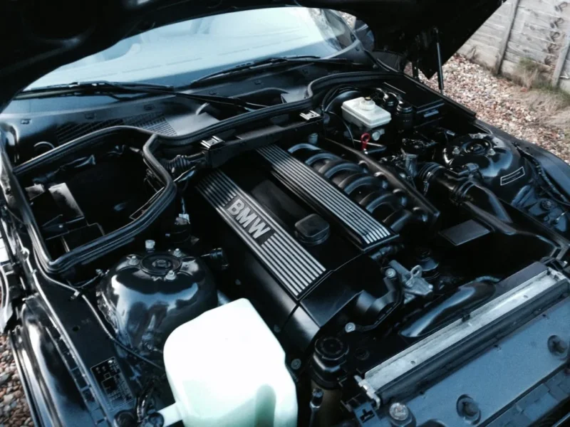

    Hopefully I shall have a more upbeat update soon.... but for now have a engine pic... Z3 Engine1.JPG
