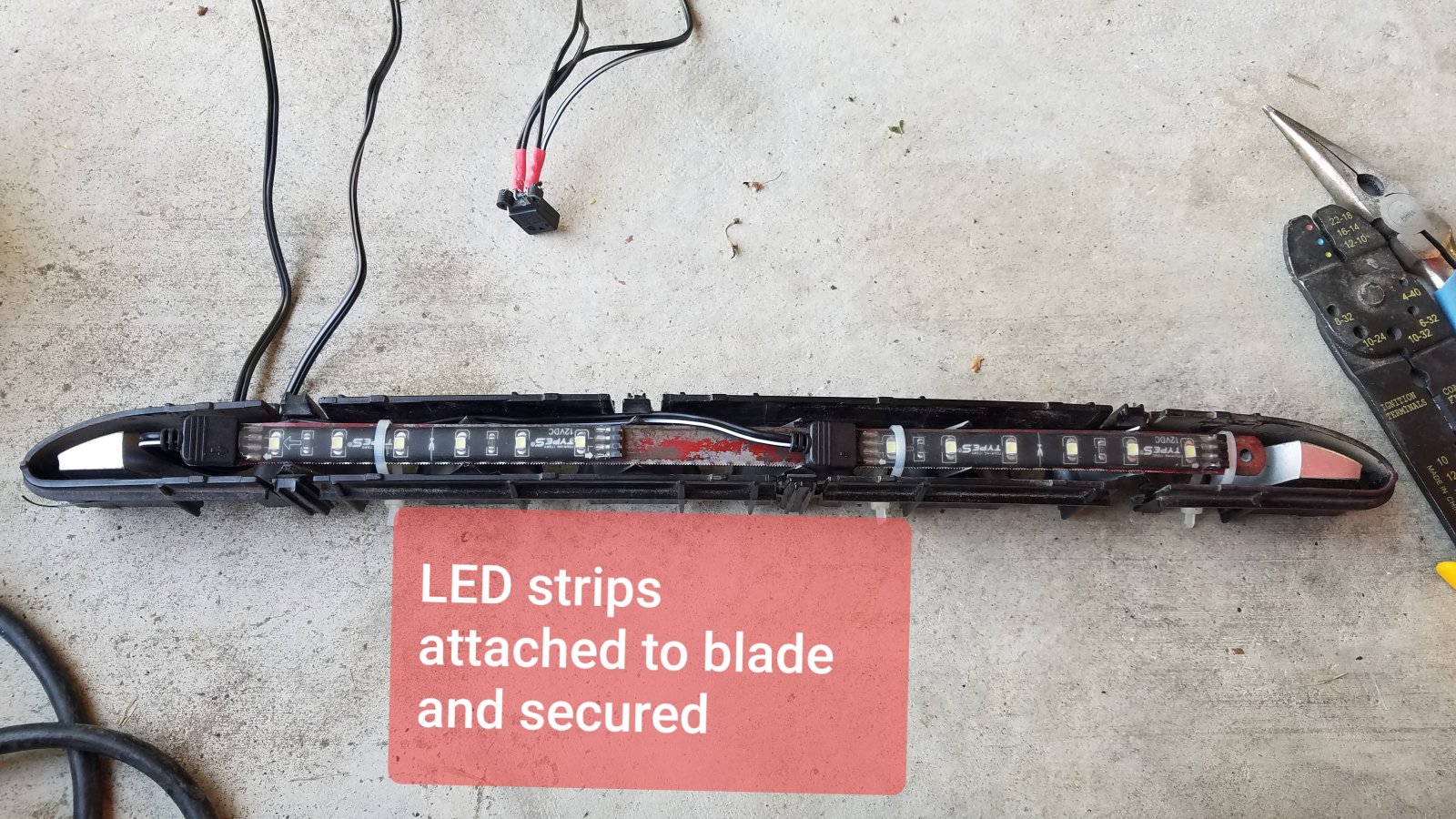

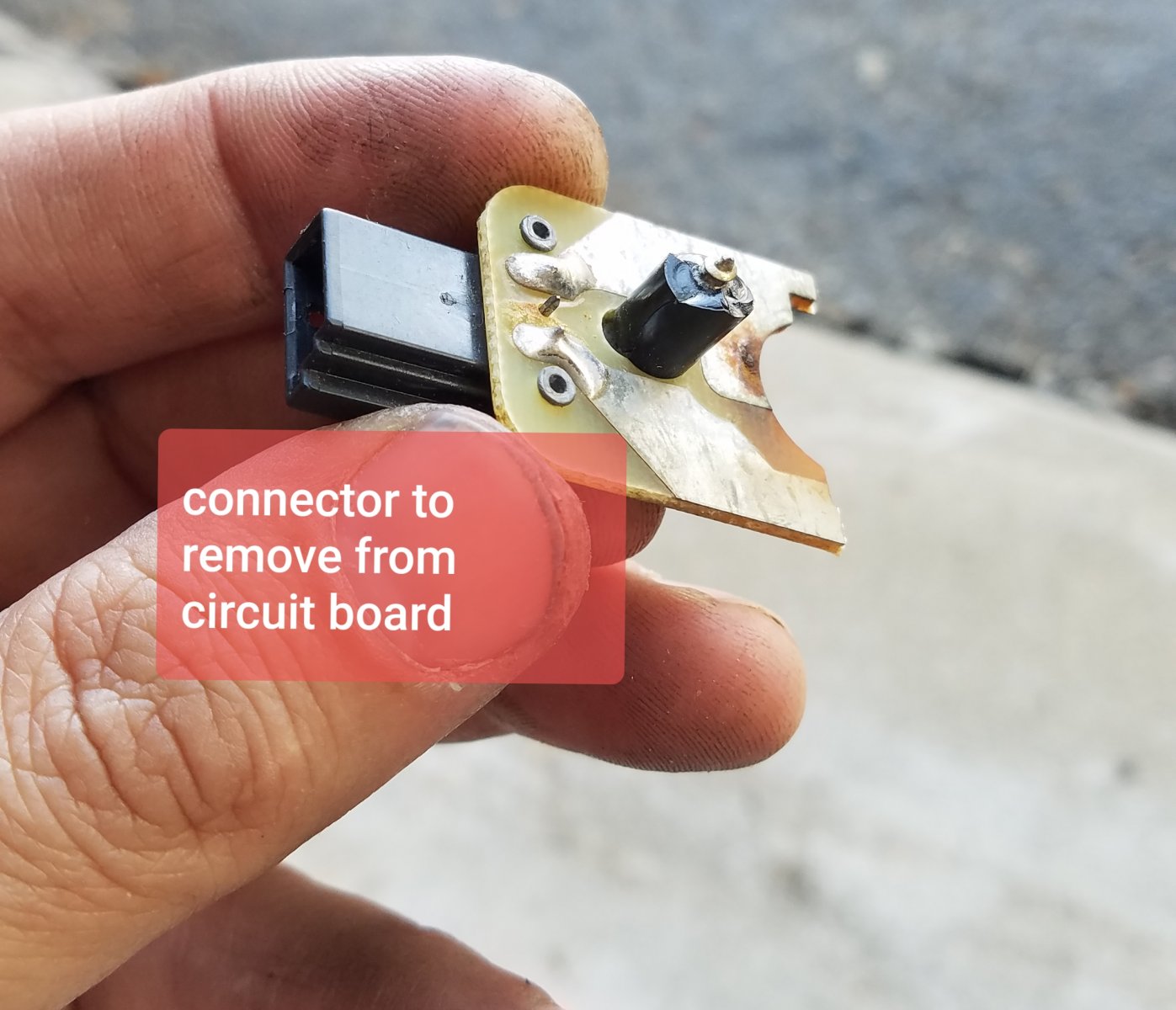

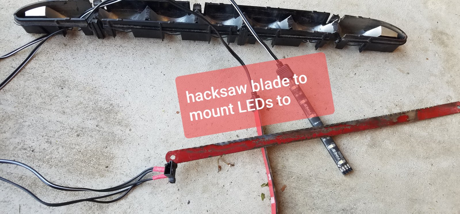

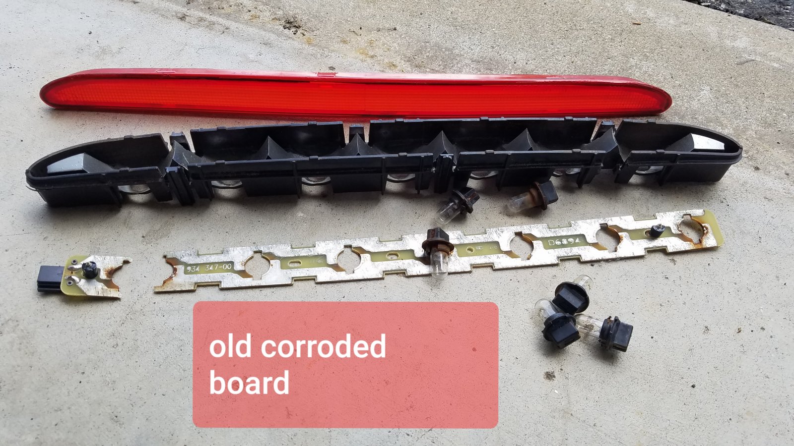

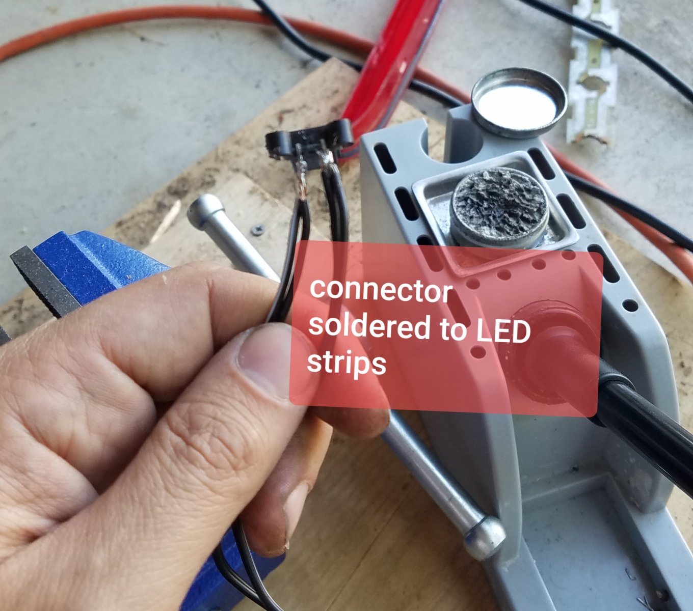

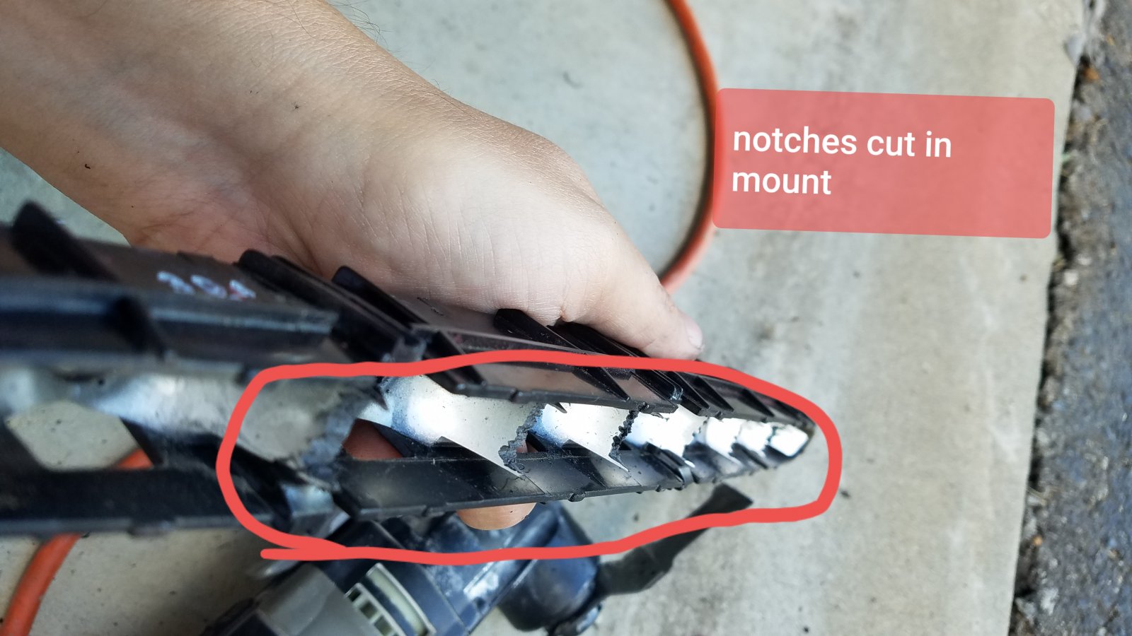

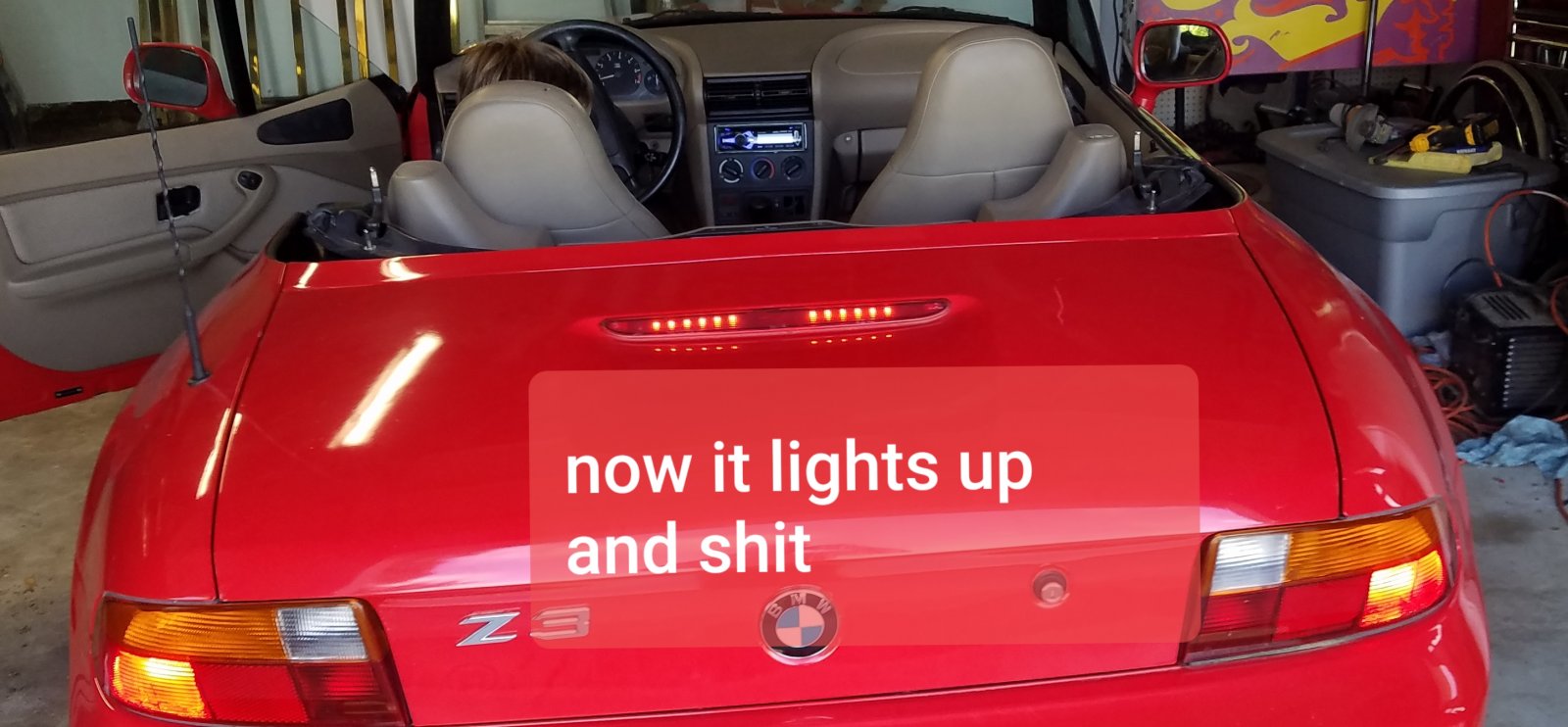

My Z3 taillight needed replacement. The circuit board was ruined and I didn't really want to shell out for a new one. I decided to get creative. Hope the link works.
Nicely done a lot cheaper than a replacement circuit board. I will take the opportunity to play about a bit and see what LEDs I could fit in there to maximise spread, make some letters or not
