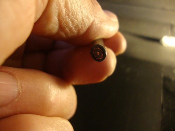

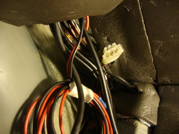

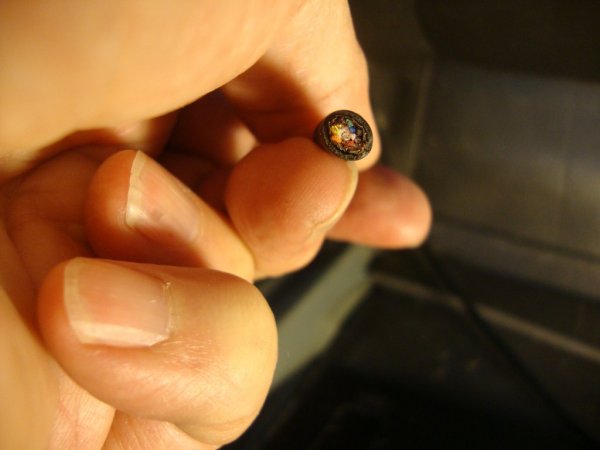

Hi Stevo and thanks for your interest. I went into the garage this morning, unpicked my boot and took the attached 5 photos. They hopefully give you - and anyone else who may be able to help - an idea of the situation. The first photo shows the area in general with the various 'loose-end' cables on show. You can see the two black unconnected cables and the coil of two other thin cables also going nowhere. You can also see what I assume to be the male power cable connector for clipping into the female power cable connector on the back of the changer.

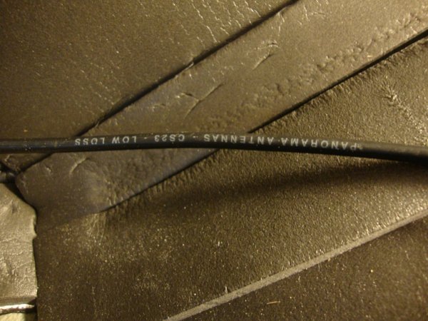

One of the black cables has numbers on it and a single core and sheath (co-axial?)cross section. The other black cable shown is the one with the multi-core cross section.
One additional thought I had this morning is that I have the longer swirly radio aerial fitted (as you can see in my headline photo showing the rear of my Z3) which I believe may be non-original on the early cars so I am guessing that the cable with numbers on it (and a reference to aerial) may be the original cable for the aerial and was made redundant when the later aerial type was installed? Does that make sense?
Assuming the other (multi-core cable) is the feed between changer and radio, then that's the one where I think I have the problem with the end connector missing. What can be done there please?????
The last picture would suggest the was originally wired for a cd changer (and maybe even had one fitted) and was “removed“ sometimes in its life. If things are pre wired the plugs are usually present ready for connection. If you can find a car being broken with the cable intact maybe you could buy the connector and a length of cable, then splice it together. Do you have anything Andy? @spurs fan in a coupe
