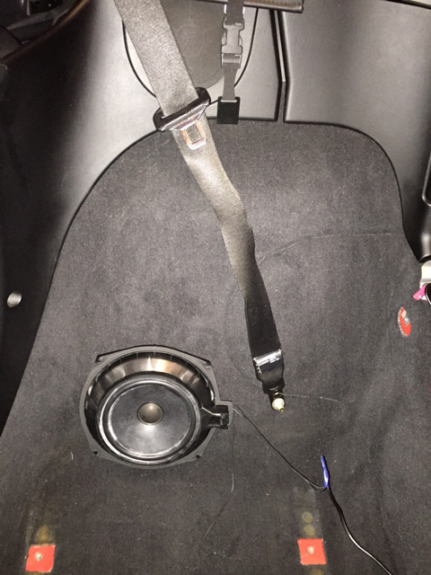

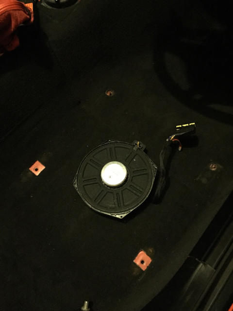

    First I removed the subwoofers from their housing that they came in:

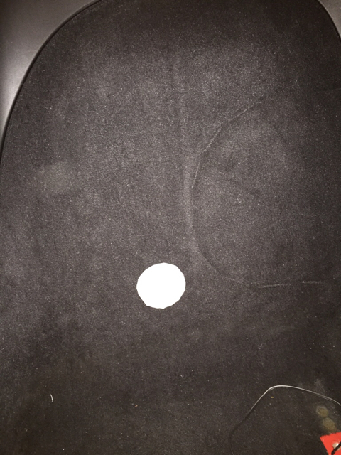

    Next, I made a template from masking tape of the magnet part of the speaker, which I would be counter-sinking into the back wall. I then offered up the subwoofer to the back wall, and placed the template in the correct position:

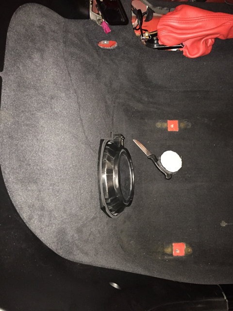

    Then, I took a sharp knife, and cut around the template, through the carpet and foam (varies in depth about 1-2cm) and removed the foam:
    If you decide to attempt this modification KEEP THE CIRCLE CUTOUTS IN A SAFE PLACE, should you wish to return to a factory setup!

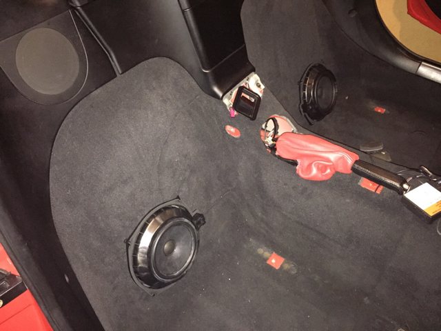

    All that was left to do was run the wiring from the back of the headunit, down under the centre console (mine was already removed as part of my refurbishment) and out of the cut-outs that were just made. As I mentioned before, I spliced into rear speaker wiring at the headunit, then I found the best path for the wiring was down the middle of the centre console, going under the carpet where the carpet has been cut out for the ashtray, and then all the way under the floor carpet and out of the circle cutouts that I made for the subwoofers.

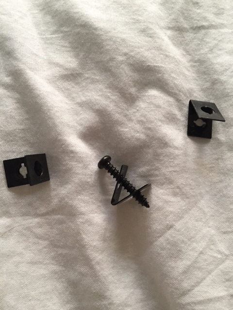

    It was then simply a case of connecting up the speakers, and fixing them in place with some 1" long screws, with quite a deep thread for grip. As a precaution (although not necessary), I also used a couple of slip nuts on the top two screws of each subwoofer to strengthen the screws' hold, which I inserted under the carpet through a small incision I made next to the screw holes:
    Et Voila! All completed in under 1 hour of install time (once the seats and centre console were out!), and for £25 total cost, I am dead happy with the result!

    Cool, how far do they stick out, looks quit a way in the pic?

    No problem what so ever then.....:beer

    They look good, so will be interesting how they sound. Depth wise wouldn't cause me any issues, as I've got short legs so my seat is always forwards!
