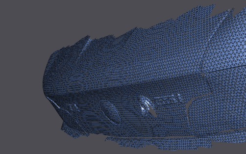

Some progress,
I was able to buy a 3d Scan of the boot, so I will try to design the spoiler based on it.
Here is a picture of it:
