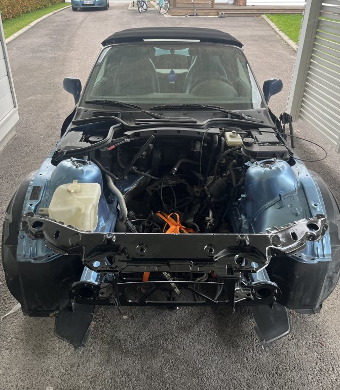

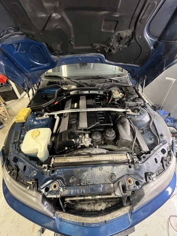

I thought that I would start a thread about my build. I spent a few months in finding a good donor car. I ended up buying a 2,2liter Z3 from 2001. The car had 180 thousand kilometres on the clock and was in overall good condition - besides the fact that engine was hydrolocked.
I took the car home and first thing I did was I pulled the engine. Hydrolocking was caused by leaking headgasket. I consider myself extremely lucky that the engine didn’t have a bent rod.

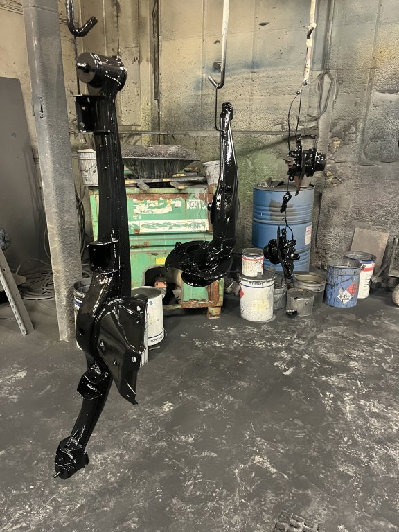

I have also removed all rust from the car and painted the bottom of the car.

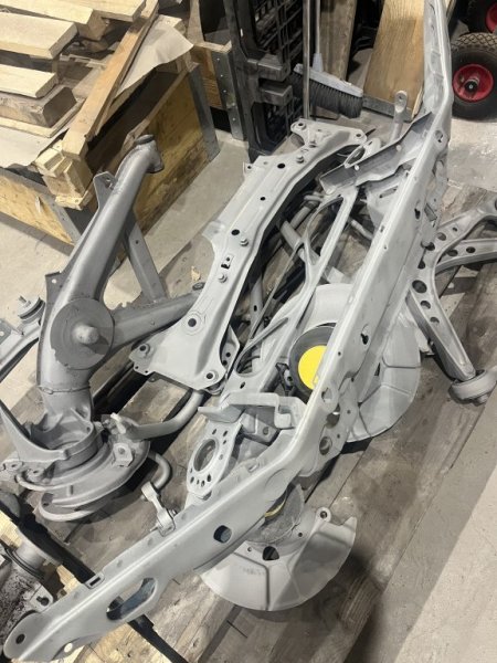

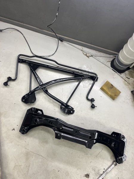

Beams,diff,brake calipers etc have been sandblasted and painted.
Engine bay has been sprayed with ferrari blue.
During next few months I will do engine rebuild and also do some changes in the interior. And also strip the car and sell parts from it.

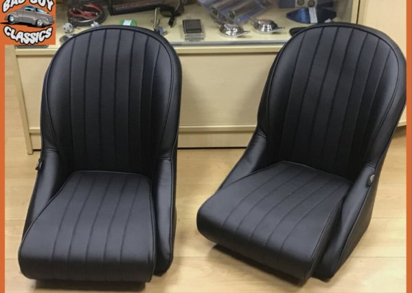

Regaring the seats I have some difficoulties to decide whether I should go for the MGB seats or if I should choose the BB Vintage seats, which can be found on ebay

Regarding seats; the space in the Z3 is tight, so just make sure whatever seats you go for fit OK and can move. Nothing worse than spending good money on seats and finding you can't get them in the correct position for driving.

Yes,I will check that the seats fit - I see these seats in some of the z3:s at least. Ideal situation would be to get them to fit the original rails 👍

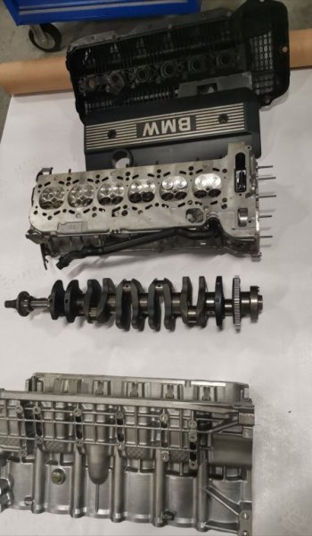

Today I bought a M52B28 engine. This engine has been as spare engine for a rally team so it has never been used (!!)
It was a ”bargain”, as you say in the UK 😃
Time will tell how difficoult the installation will be.At least the throttle arrangement is a bit different on these engines.

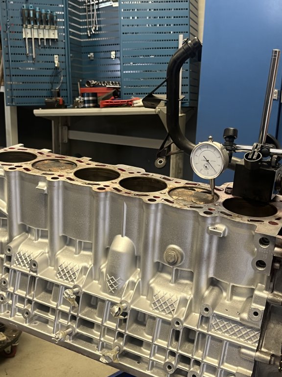

Today I also got all the gaskets and parts for the M54B22 engine. I think I will assemble that engine and sell as rebuild engine when it’s done.

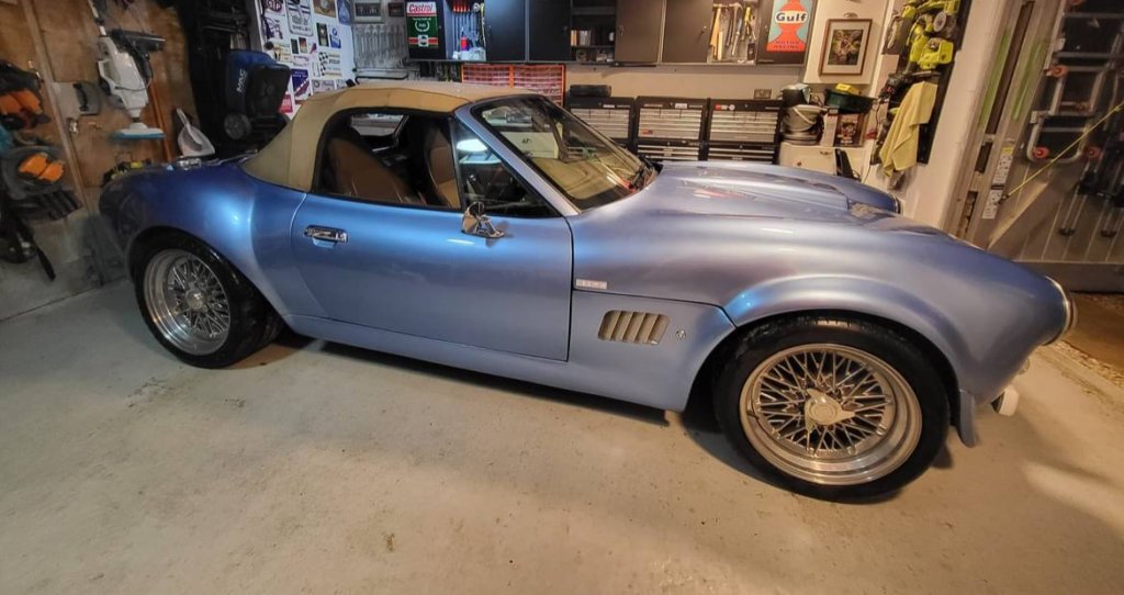

Z3 2.2 Kobra rebody (see pic)
Good luck with the build. Tribute, or their UK agents Classic Coachworks sell the 2fifty these days but in a limited way to avoid dealing with F.... Classic have also built quite a few of them for customers so have good knowledge of what seats fit etc. They are not keen on the quality of the BB seats as I recall in past conversations.
Many have been built now and, as I understand it, the best bumpers come from Harringtons but are Not cheap.
If you do FBook there is one member there called Manesh. Those wheels are on his Kobra so he can report on the performance of his wheels. Classic Coachworks can be contracted via their emails or better on FB also. Give them a few days though as very busy. Especially in the next week as doing a charity drive in Europe.

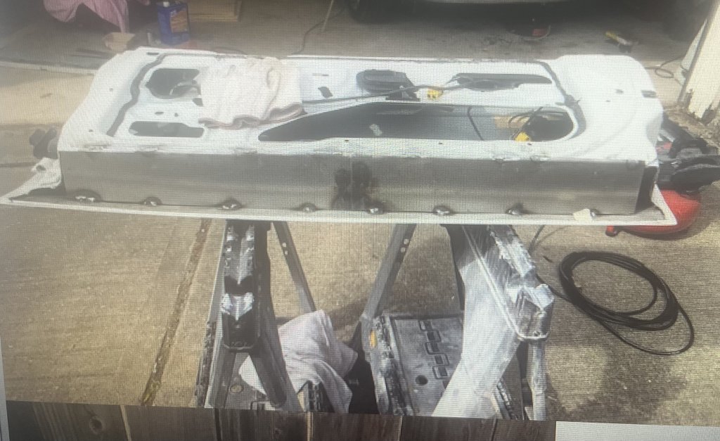

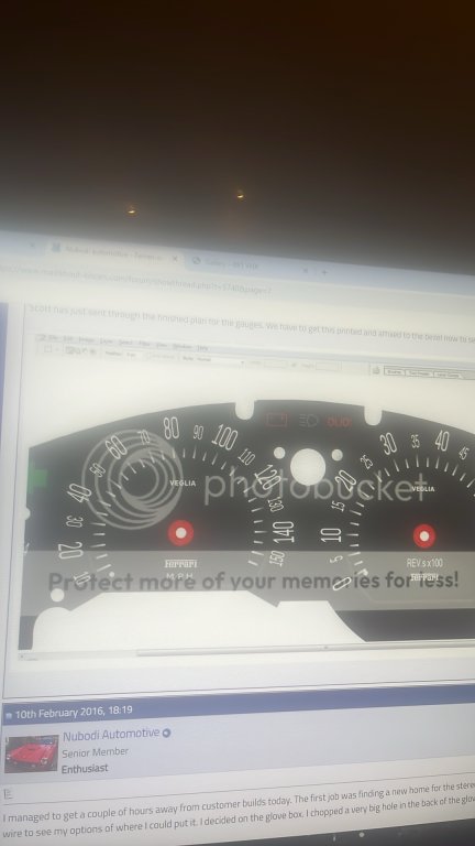

I was on madaboutkitcars forum and I read that there was a user,who was modifying the gauge faces on z3 and had the files up for download. Unfortunately the link there does not work anymore. Any chance that some of you would have this on your computer that you could share?Unfortunately it’s not possible to access forum registration anymore.

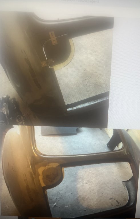

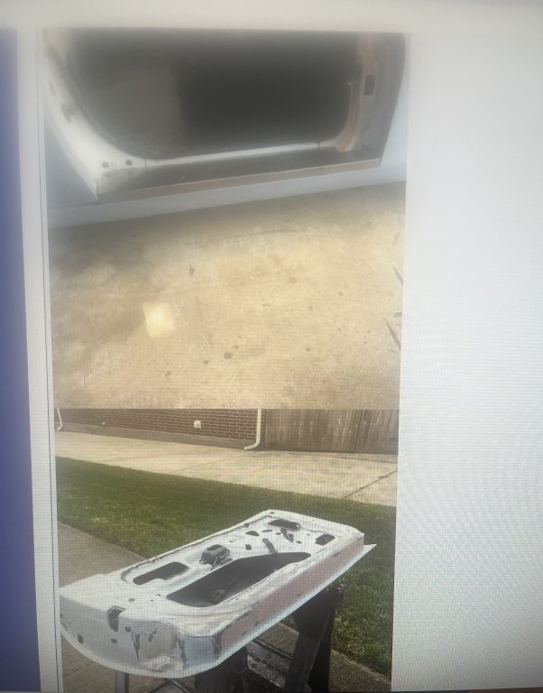

One other thing I have seen that some cut the doors and make a rounded shape in the lower corner of the door. Anyone done this and would have pictures to share of a finished product?
”Ace” on the madaboutkitcars forum has done this but no pictures of a finished product
