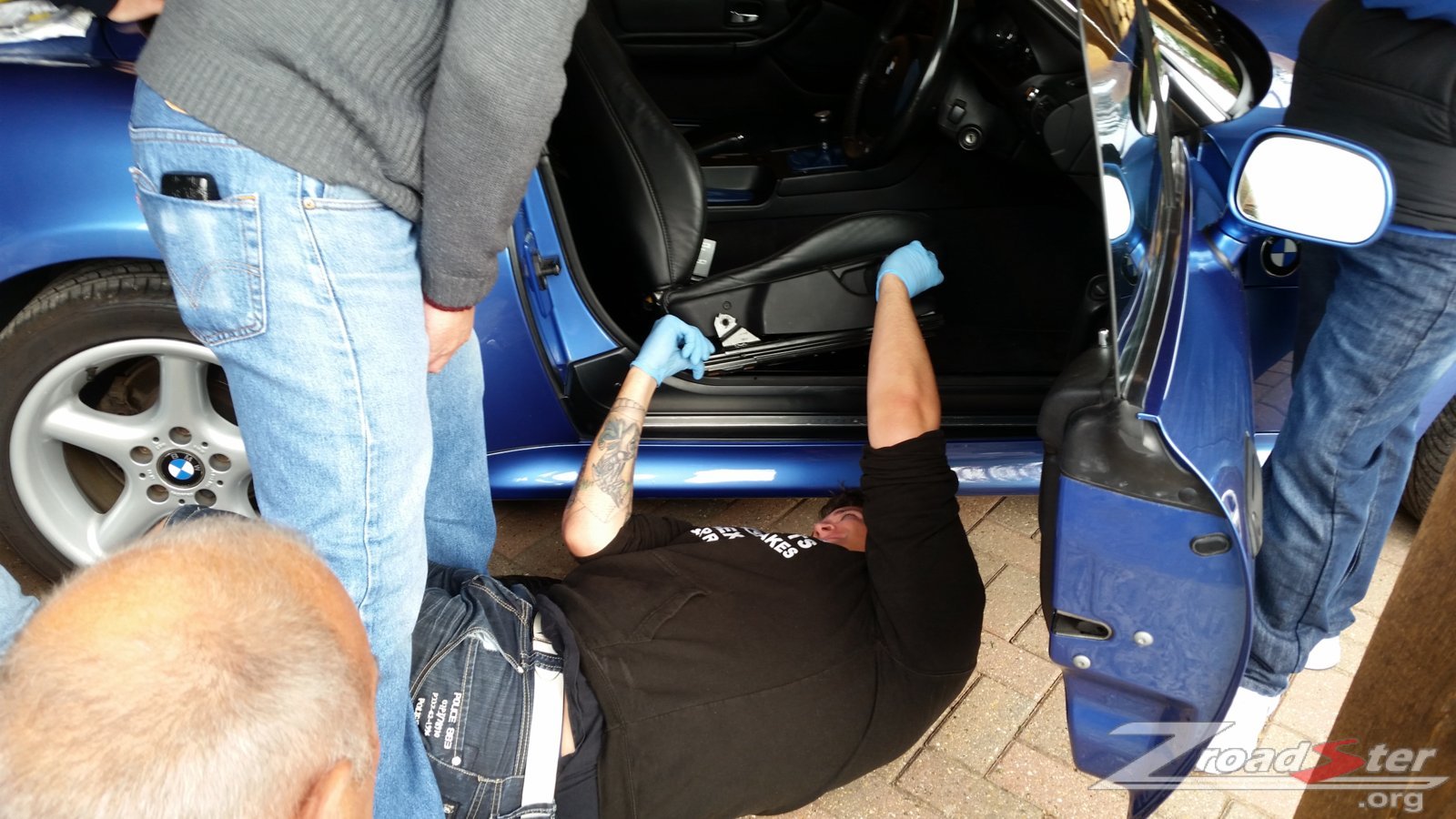

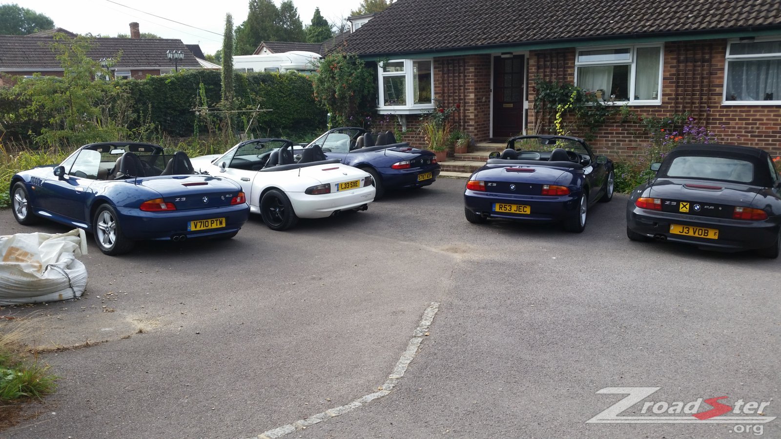

    What an interesting day, not just for the training on seat bushes. Got to meet some new faces, and in total we had 7 Z3's attend :)

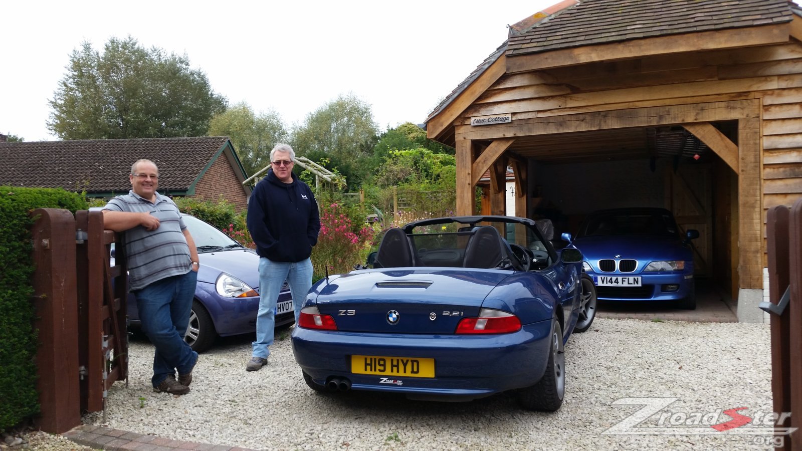

    @pgunter (right) & @Nifty Fifty (left)
    Overflow car park provided by Paul's next door neighbour. Zeds lined up nervously awaiting being tinkered with...

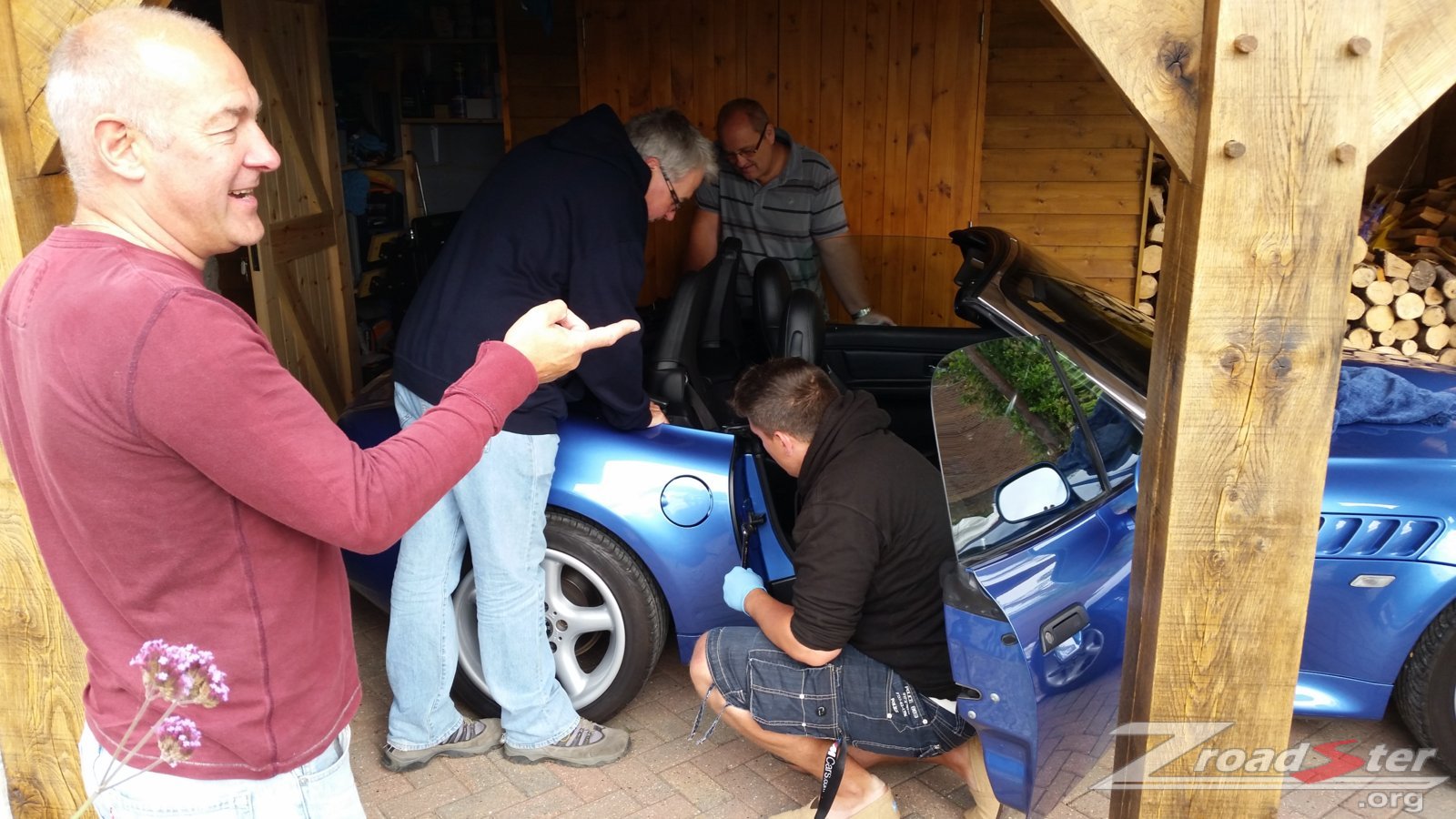

    On to the action now with @Lee showing us the seat removal process. 2 nuts at the front, and 2 bolts at the back!
    At this point we learnt that it was best to make sure that once the seat was unbolted, pushing the seat back as far as possible on the rails was a good idea. We had to put the seat back in temporarily to power it as we couldn't undo the seat rails to remove the kebabs!

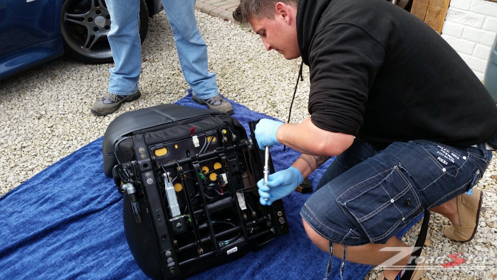

    Got the first seat out of Paul's car and we have a good look at the workings, wiring harness, connectors and motor locations.
    Close of the underside of the seat for people who haven't ever looked ;)
    Lee removing the bolts from the seat rails to allow the kebabs to be removed.

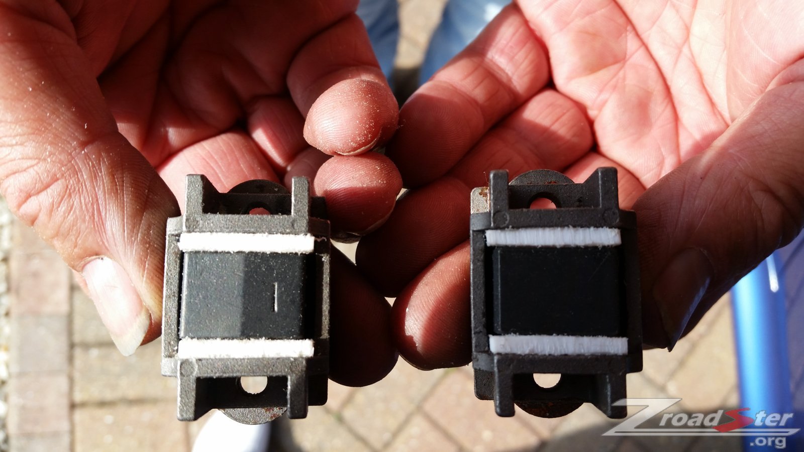

    The seat bushes once removed from Paul's drivers seat didn't look to be in bad condition. However on closer inspection they were starting to deform slightly. We fitted the new bushes any as it was in bits!
    The bushes as supplied are thicker than needed and require sanding down to the correct width. We tried several techniques, but eventually designed and built a block of wood with a square hole in it to hold the bush in place! It was way more efficient than our first attempt in this picture...

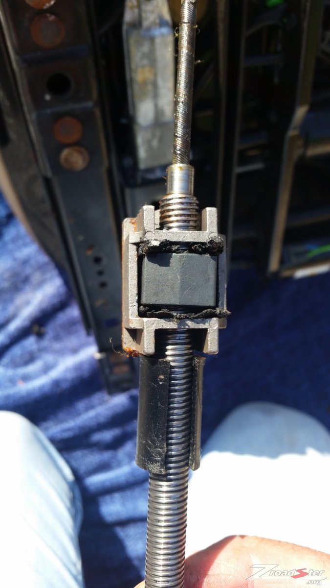

    Next up was @La_vida_diver's car. I have a video of how bad his seats rocked which I'll upload when I get chance. The next couple of pictures show how bad his bushes had deteriorated.
    The first kebab showing badly deteriorated bushes.
    Second kebab again with seriously deteriorated bushes.
    What was left once the bushes were removed from the kebabs. No doubt these were seriously in need of replacment!
