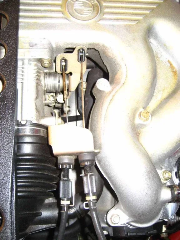

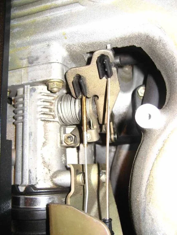

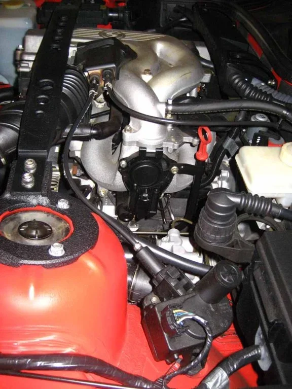

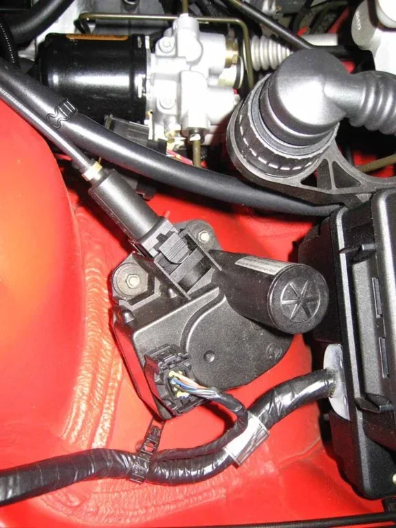

Thanks Vintage42. Mine is also a 97 and your pics will make life easier for me as I piece together my CC. I bought the actuator and it will be shipped with my other purchases by the PO. They don't allow loose parts while onboard ship due to theft so need to get all the loose parts shipped separate unless I paid £600 more for a container. From the pics it looks like the bracket to attatch the cable is the important piece. Was all the wiring already installed such as the clutch switch? JIM
vintage42
American Zeds
Dec 24, 2013
39
... Was all the wiring already installed such as the clutch switch? JIM
My cruise control was original equipment put on by the factory, so I can't say. But the second photo shows a sub-harness coming off the main harness for the cruise control motor, so I expect the entire car is pre-wired for whatever the cruise control needs.
There is a switch on the clutch pedal that prevents starting unless the pedal is depressed, but this is not related to cruise control. I suppose you are talking about connections in the harness for switches that turn off the cruise control if the clutch or brake pedals are used.

zedonist
Guest
The photos above show two different throttle body configurations, one M44 one M43, I assume there's is also a bracket change to allow two bowden cables. My 99 M44 has the same as yours, space for the cruise Bowden to be connected.
