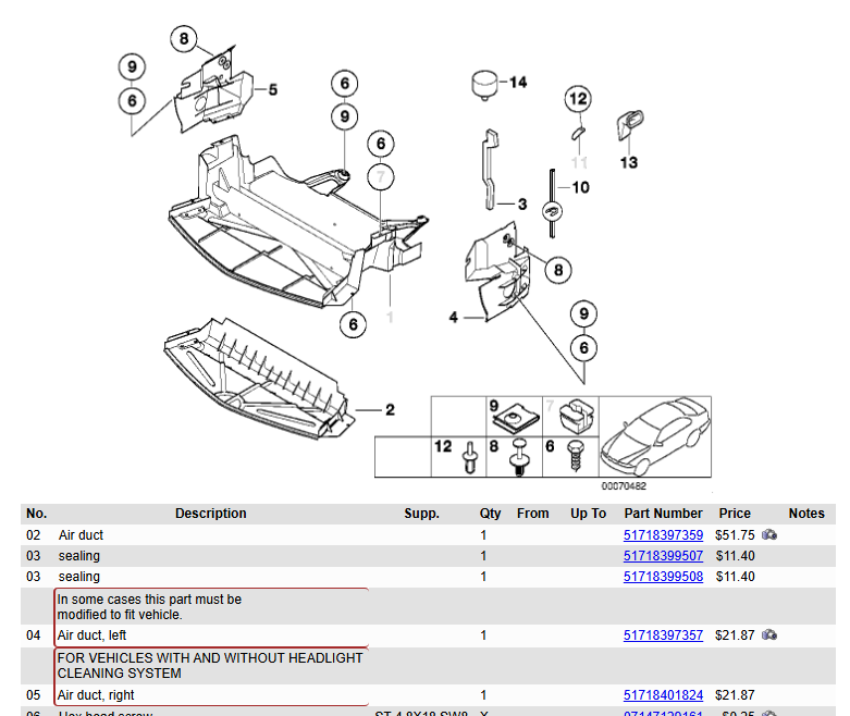

My 2.8 has a little "splash shield" at the very front of the car, covering the radiator from the bottom
However... this is the only under tray covering the engine bay, it seems rather few, compared to other cars I have worked on
Do all 2.8s have this lack of under trays??
If so do people know of any good aftermarket ones, or OEM ones that fit?
Thanks Chris

Not all models had the full undertray. You can check on Realoem to see If it was fitted to yours, if the picture is greyed out then it wasn't. I suppose one could be retrofitted if you want to go down that route. The 'splash shield' in BMW terms is called the air duct, it directs airflow up to the radiator.

As you've noticed the 2.8 had a front lower shield for rad air flow. Get an under tray from the 2.2 or 3.0 these will fit fine.

Interesting about the air duct!
All undertrays are greyed out for me

My 1998 2.8 only has #2.
My previous 1998 build 1.9 had #1 and was an utter pain in the arse. I was delighted when I discovered the 2.8 didn't have the larger one.
Hmmm...
maybe i should rethink my choices
It sounds like it does more damage that it is worth
