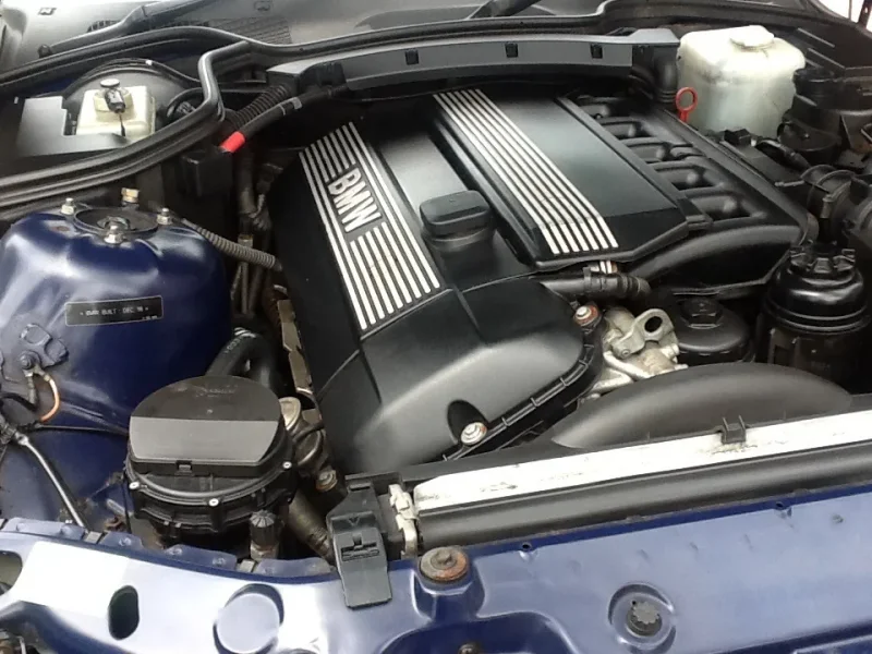

M52 single vanos as fitted to pre Oct 98 zeds, notice the circular bulge at the front of the rocker cover.
M52TU twin vanos engine as fitted to post Oct 98 zeds, notice smoother aspect to front of rocker cover.
