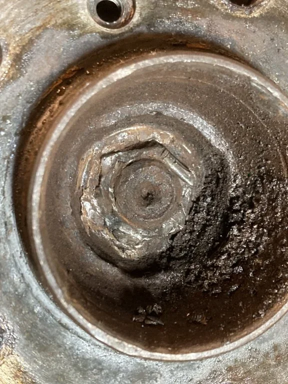

...This is a nightmare I had recently. The nut had fused itself into the hub flange with rust. Nothing was going to shift it...
Mine were a little worse Andy, no nut at all, completely rusted away...

Later cars are definitely worse. The corrosion is the nut's steel lock plate. I popped a pair of shafts from a 1997 1.9 Z3 onto my Compact before Xmas and the locking plates were still clean and anodised on both cars. My rear trailing arms are still pretty good as well but Compacts don't seem to have that ghastly rubberised coating.

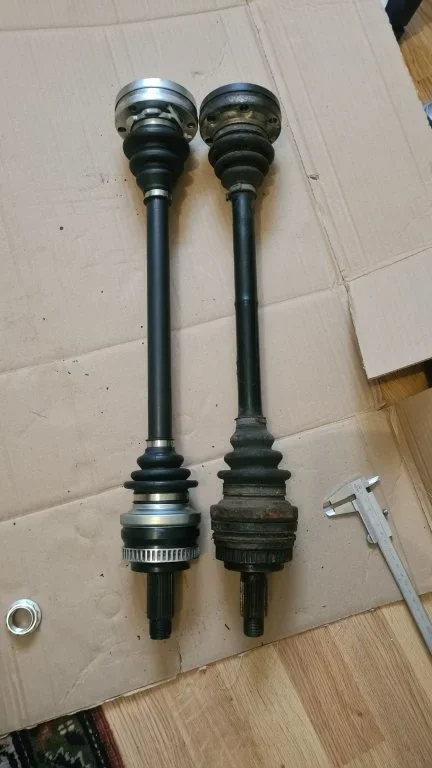

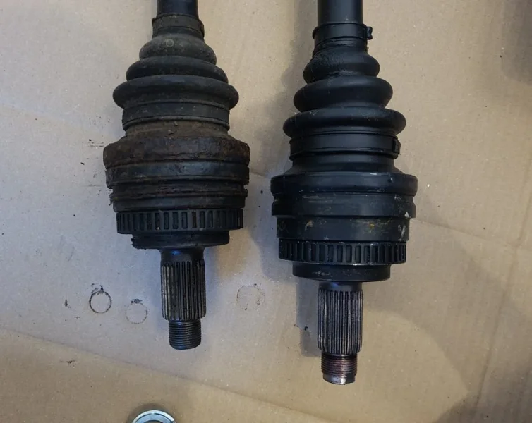

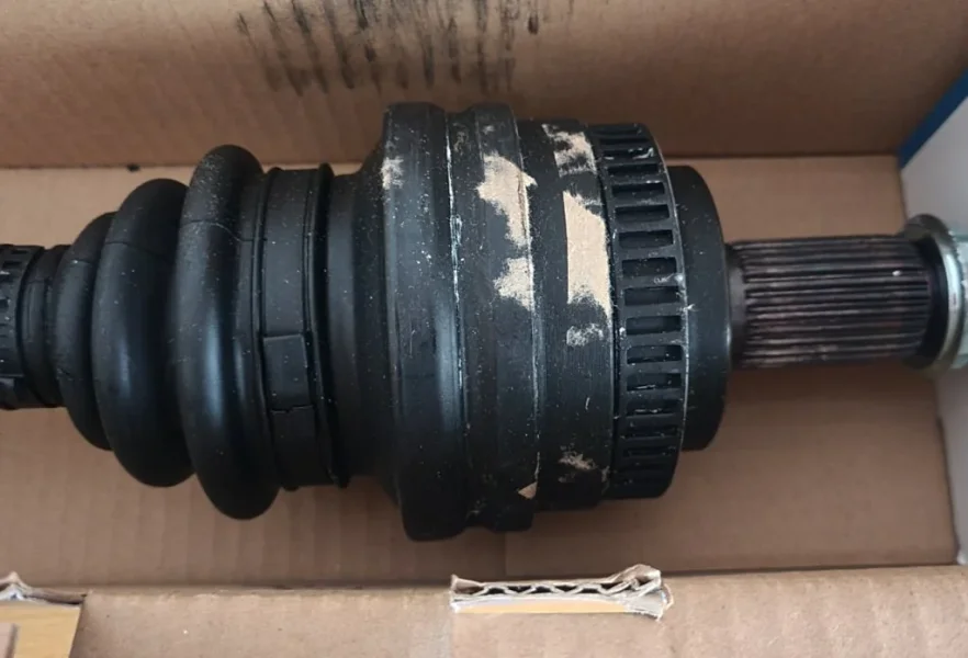

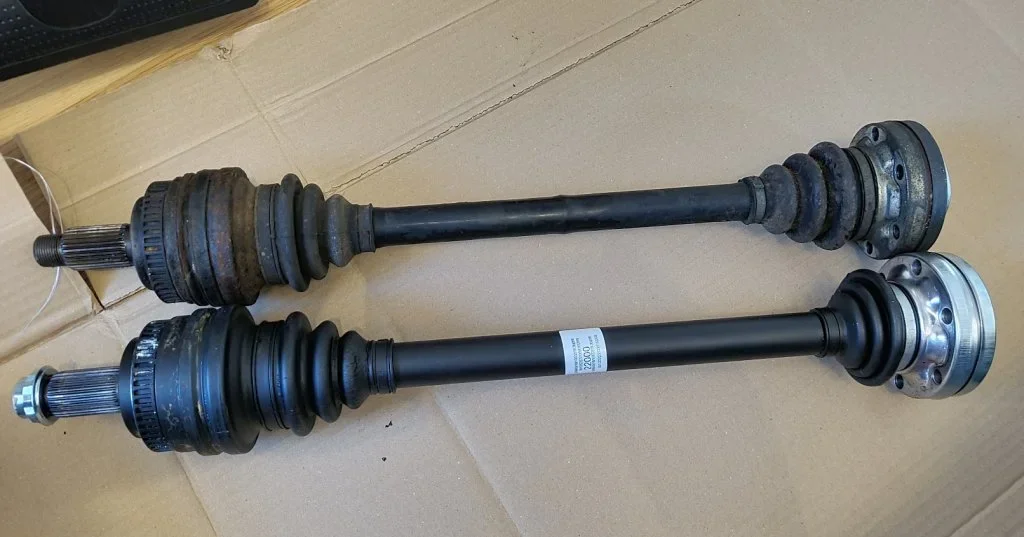

First shafts from GKN/Spidan/Löbro arrived yesterday.
Some background first: after a lot of research I came across a supplier who advertised the model 22000 from GKN/Spidan as an alternative to the original shafts. According to most online shops, this shaft does not fit the Z3 but various models of the E36 series (also 2.8), but since the dimensions were identical except for the nut (M22 vs. M24, a lesser problem which can be solved), i wanted to give it a chance.

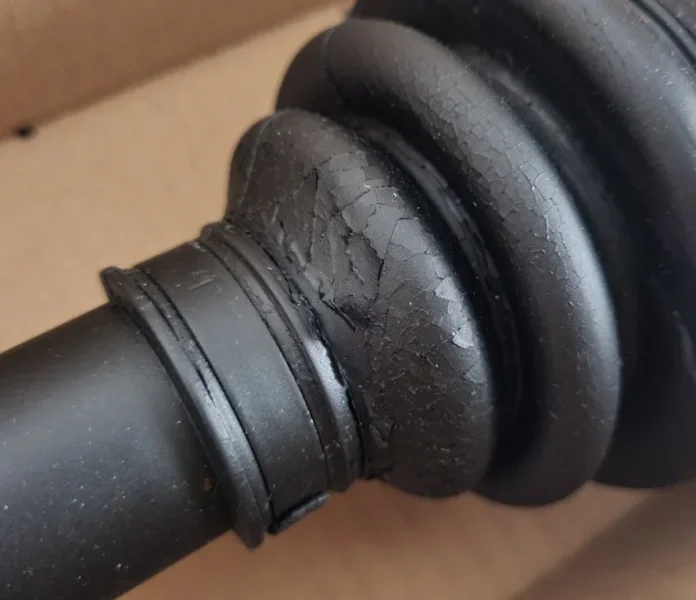

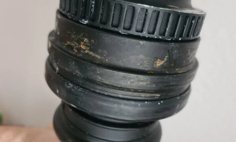

Considering the price though (~ £170 each) it's one large disappointment: there's paint all over the boots and clamps as well as starting corrosion on both shafts. Obviously the shaft was packed while the paint was still fresh. They failed with such simple things as derusting and painting, what quality can one expect from the rest of the work then?
And that leads us to the biggest flaw: one ball joint already has some slight play, barely noticeable but it's there. That's totally unacceptable for a company that claims to be among world's leading suppliers for shafts, joints and other suspension components. I know they didn't recondition it themselves but it's being sold under their name.

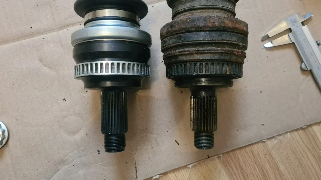

Concerning the measurements: the thread is M24 instead of M22 which means you would have to use the right nut from an E36, everything else is identical. BUT: while the length of the Spidan shaft is almost identical to the original shafts while compressed, it's much longer when it's fully extended although length difference should be only 5 millimetres according to the data sheet.

Quite the difference already. Other issues we came across were the position of the abs ring in relation to the hole on the arm, some where 10mm out, also the bolt hole size on the diff end was always the smaller E36 bolt which was no good for our medium case diffs.

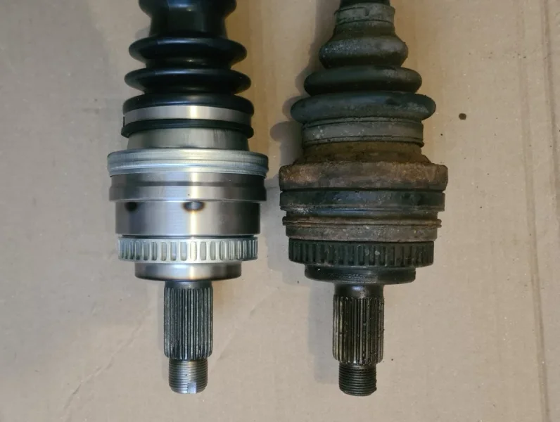

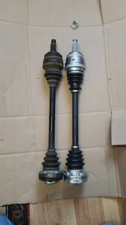

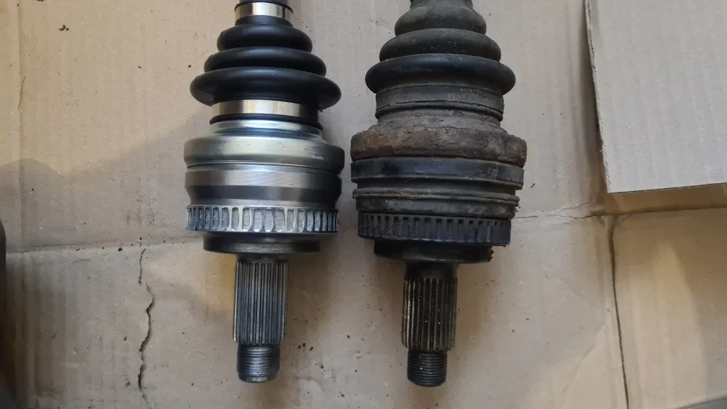

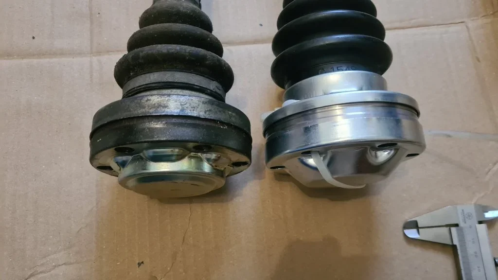

Yesterday the shafts from Ridex, Stark and ERA arrived.
Ridex: overall very good quality, the ring for the ABS sensor is positioned correctly such as all the other (important) dimensions match the original shafts.
Nonetheless the overall proportions are different, but that's irrelevant unless it should look like 100% OEM.
There's some minor play in one of the joins though so I guess you just have to live with that.
Stark: absolutely identical to Ridex, nothing else to say here.
ERA Benelux: reconditioned shafts with overall very good quality, but again: quite expensive (~ £180). Again, some play in one of the joints but barely noticeable compared to the GKN shafts. While the position of the ABS ring matches the original shaft, the joint itself is quite smaller (in height and diameter) so I hope this is no indicator for robustness.

Those Benelux recon's look a good fit. Those catch my eye.

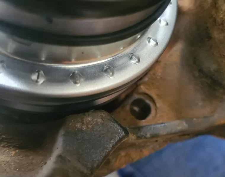

The shoulder on the stark units might cause you issues with clearance. (first shoulder after the spline) we have a set identical that had to be machined down.

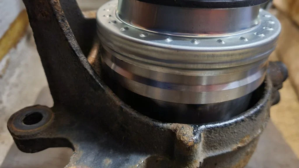

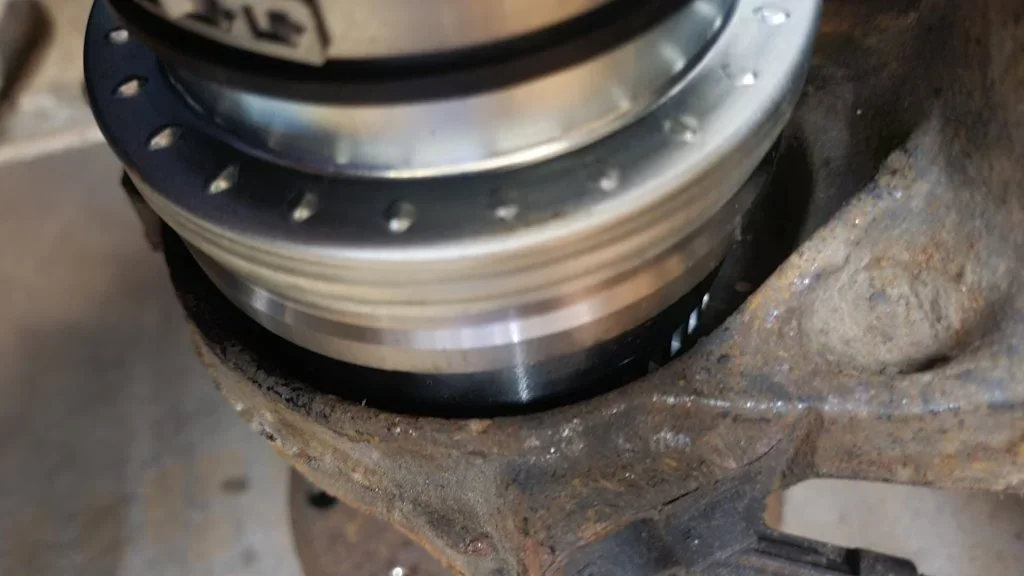

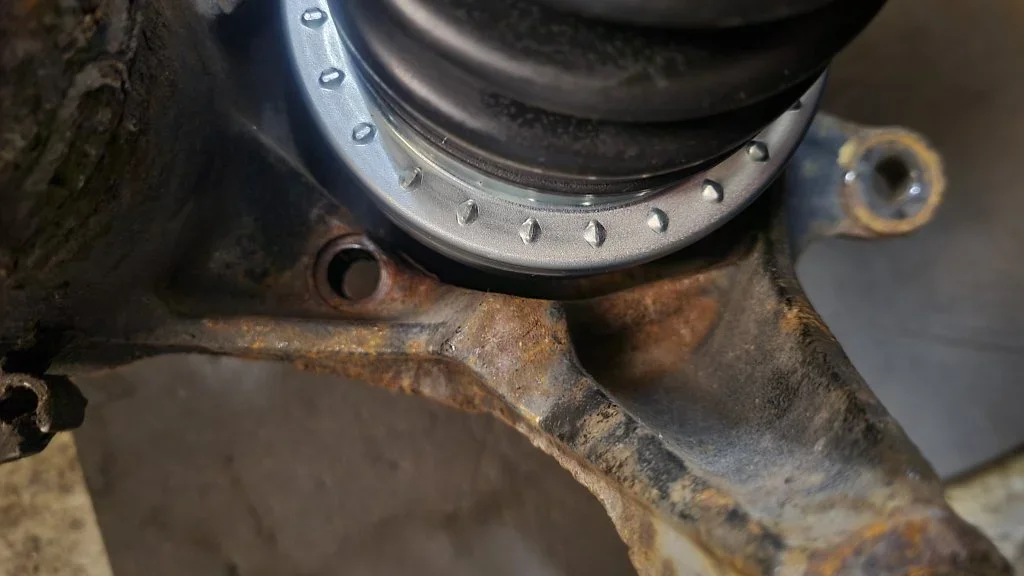

Good point, it didn't appear to be too large but I wanted to check this. Since I already removed the wheel hub and bearing, I tried to arrange everything as good as possible to be able to "install" the shaft.
As you said, it's a very tight fit but at least I couldn't see any contact to the trailing arm (as far as I can tell judging by this experimental setup :whistle: ). Don't know if the pictures are any help.
But it wouldn't be my first choice either.

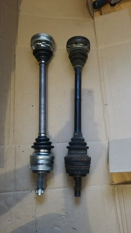

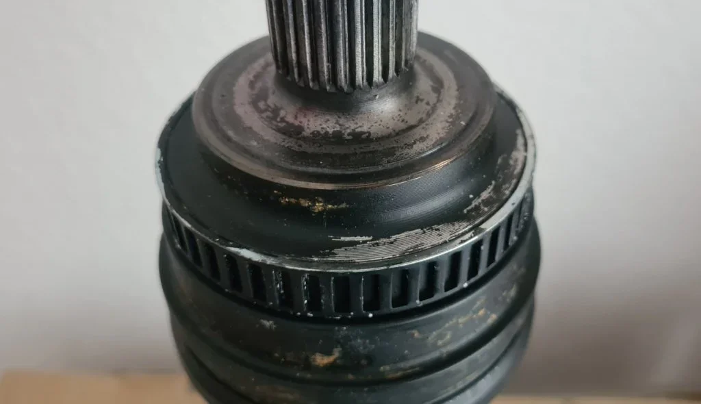

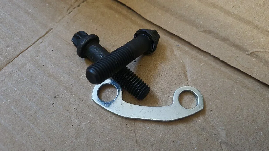

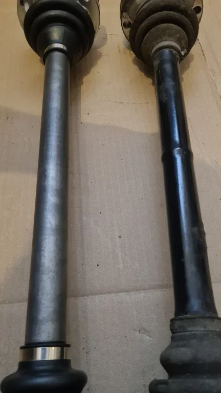

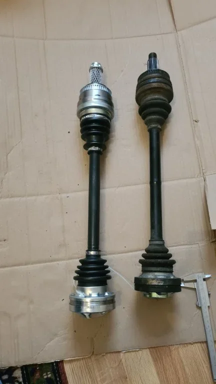

Today the GSP shafts arrived and their overall quality is similar to ERA and Ridex, although it looks more like an original shaft (same as ERA). They come with additional parts such as bolts which appear to be of good quality.
There is a bit of a peculiarity though: the shaft has no paint, it's actually bare metal. So while everything looks very solid you would have to give them a quick degrease and some rattle can paint job. On the other hand they cost only £50 each so I could live with that...
