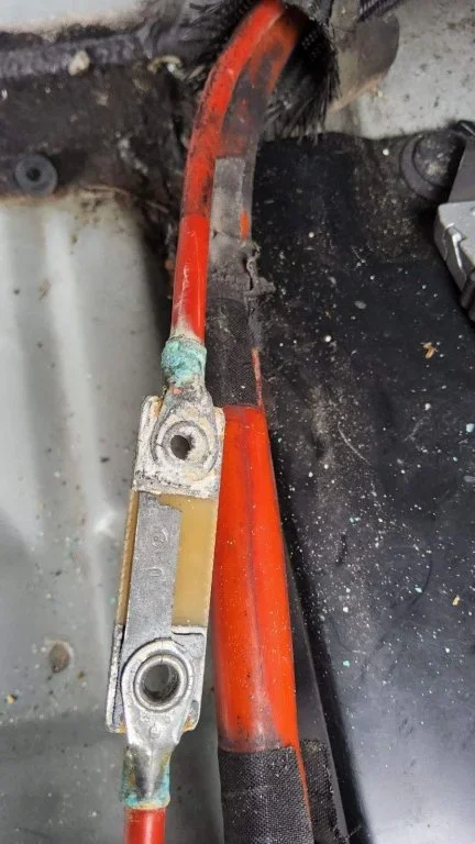

Hi to those who responded to my request for help. Attached pic showes a bad connection, as a result not sending power to the DME. Now sorted and looks like a new crank sensor is needed. We have fuel...just no signal to the ignition. Nearly there but hope this may help others if ever a similar issue arrives.
Mark
