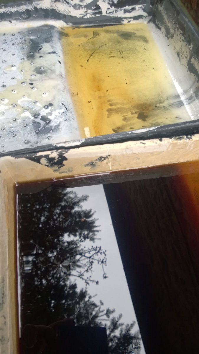

Changed the diff oil, guess the fresh oil
Straight forward but no one explains the 14mm hex socket is a pain to get in, hooray for the camping mallet

Funny thing was, when it first poured out, I questioned whether it had been done previously as looked ok, I guess i was thinking engine oil, one it was drained and I opened the new stuff I realised quite how grot it was.

Ok, Oil 2litres just check with Opie Oils, 2 crush washers, and I can post you those, Sopers were brilliant as usual and let me have 4 FOC, 14mm Hex socket and 20 mins. If I can do it, anyone can. Just remove the spare, makes access much easier, I didn't bother jacking of ramping, you can reach.
