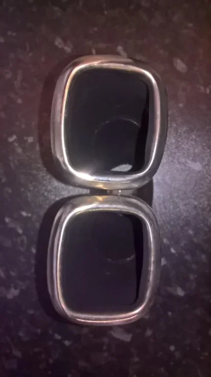

Just thought I'd start a thread re the above, following on from Ben @le frog having one fitted at Custom Pipes in Doncaster.He went for the twin square tail pipes which he really liked and they did a great job of fitting it.
However it produced an unbearable droning noise at steady motorway speeds.
So after a few phone calls to the supplier they said that the tail pipes could be the main cause as they had a quite big return lip on the end, which in effect causes a restriction to exhaust gases dispursing.
Personally I thought it unlikely but Ben went back and the chaps fitted round tail pipes similar to mine.
Surprisingly it made a big improvement, no droning noise and sounds so much better in every way.
The first set
The second set
Looks much better to me anyway :cool:

I, like you, thought they were fobbing you off. I stand corrected, so it was the tail pipes.:rolleyes:
Agree the round ones look much better:thumbsup:

I also thought it sounded like a fob off, great outcome and very surprising.
If you look at the exhaust tips that Mat, Machine Monkey makes there are no lips on these, maybe not a coincidence.
