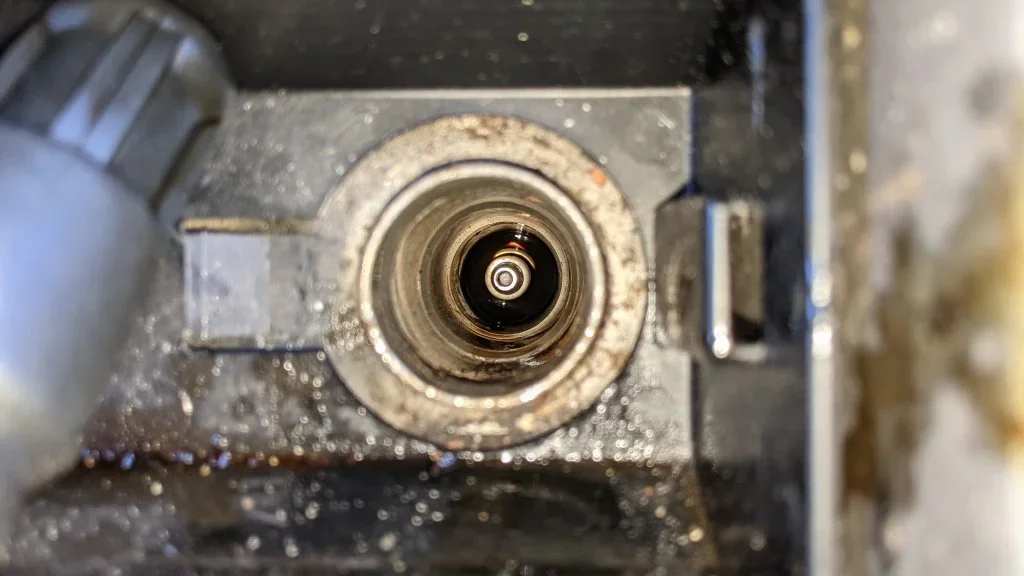

Had an interesting problem with spark plug 2. It seems to have something hexagonal sat on top of the 10mm nut:
For reference, this is what all 3 other plugs looked like (all new now)
Need to get some needle nose pliers long enough to try and grab it. Other than that, servicing is done!
