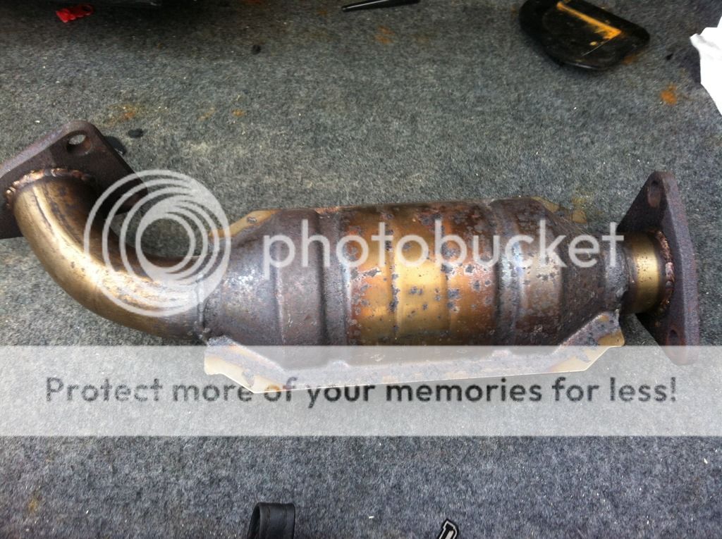

Hi thanks for the quick reply. Did the cam sensor a month ago kept getting cam fault code. Checked live data and lambda is switching OK. Suspected the cat cause when I bought the zed it looked like a cheap botch job. Recently been getting a bad rasp noise and rich smell at the tailpipe. The car runs sweet at pulls very well.

Makes sense getting a emissions check done. Just thought everything else is OK and the lambda is working OK. The cat that's on when I bought the car is a real nasty one.

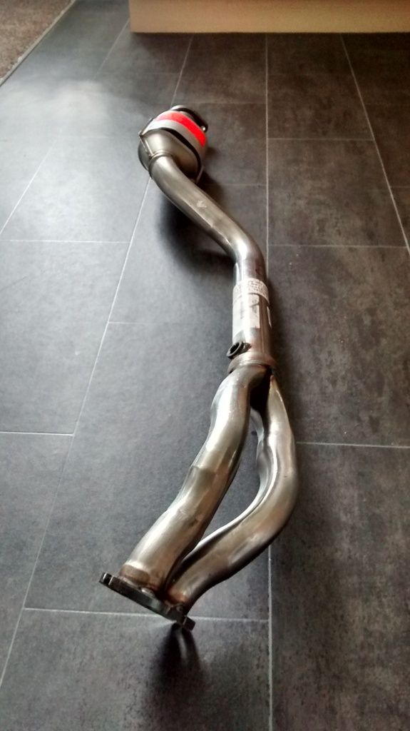

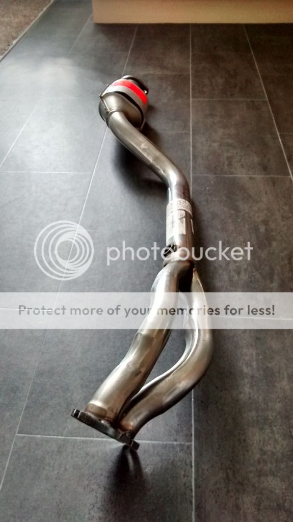

bit the bullet and got a new cat for the zed.
decided to go for a react cat from eurocarparts... £73 and £56 for a bosch lambda sensor while iam at it
just got to fit them... the cat looks well made....

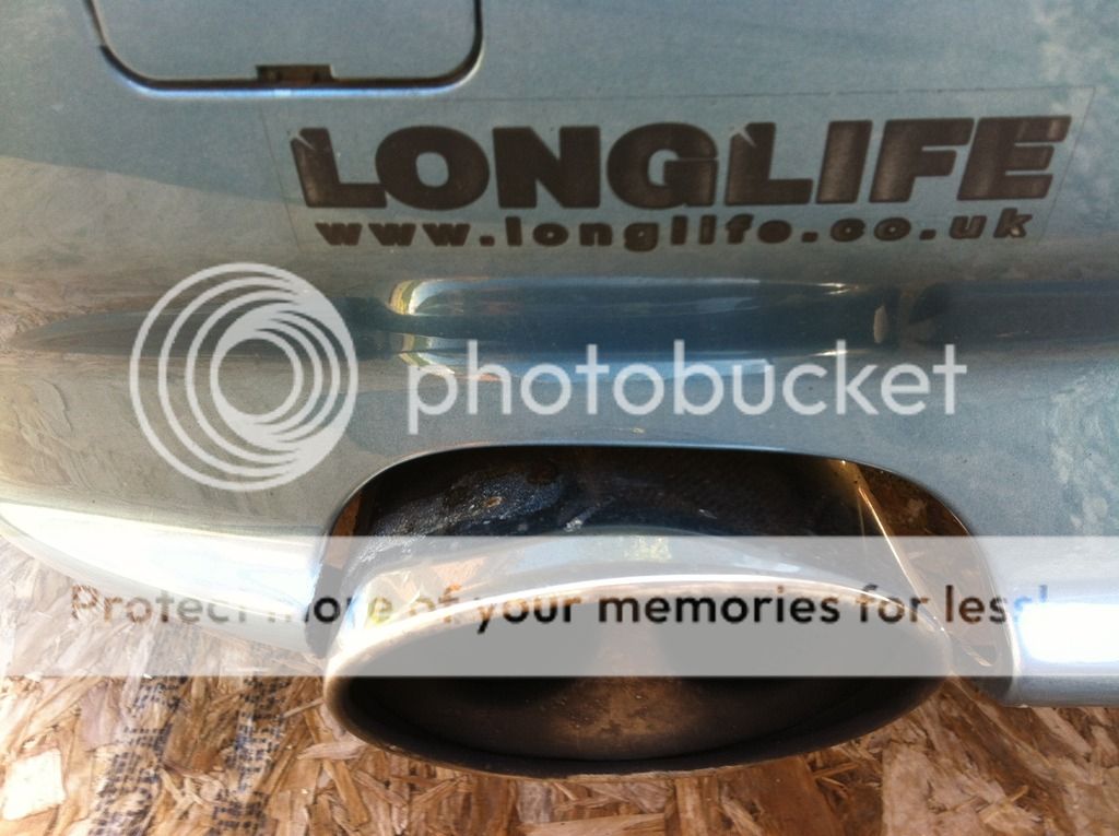

Administrator
Administrator
Global Moderator
Dec 2, 2011
Berkshire
Z4 MR
@spurs fan in a coupe has a 1.9 Long Life exhaust at the moment I think. Maybe the back box off that would be an idea?
